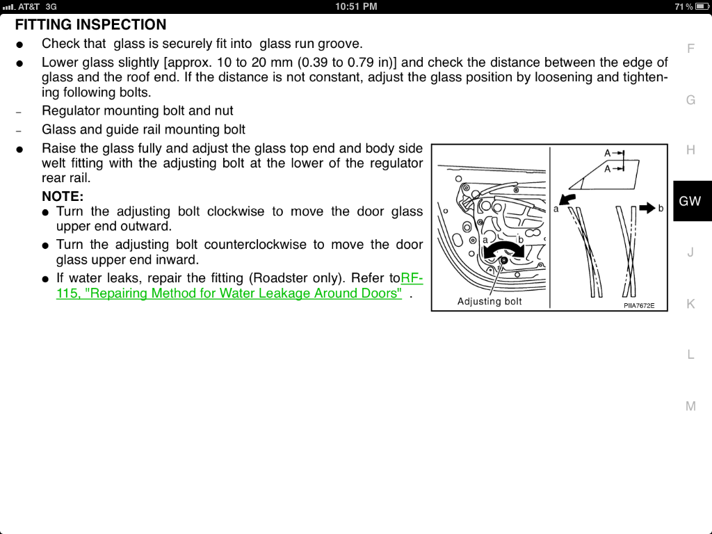

Sounds like your window is out of adjustment. I don't have my manual with me but I believe there is a way you can fine tune the fit of the window to the seal by an adjustment screw or there may be enough tolerance to move the window where it bolts up to the track assembly.

Post
Hope you find this useful. Worth a shot...

Smile
Thanks 350TX I'll try this, this weekend.
