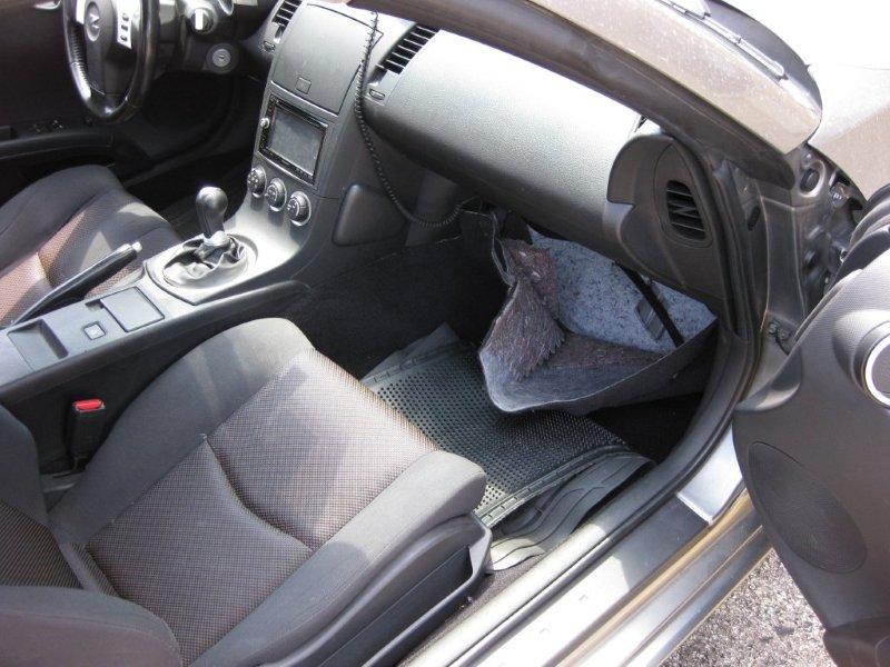

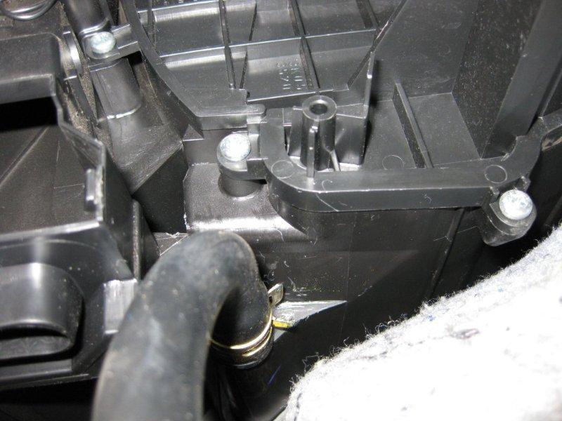

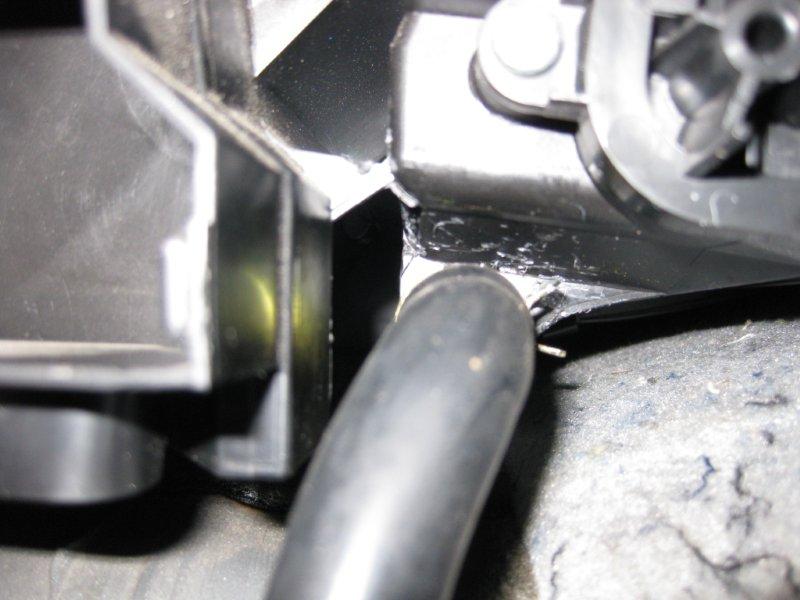

Default 350z A/C Drain tube interior pictures
https://my350z.com/forum/members/344...-pictures.html
Attached Thumbnails a/c drain tube location???-img_2743-.jpg   a/c drain tube location???-img_2744.jpg   a/c drain tube location???-img_2747.jpg   a/c drain tube location???-img_2748.jpg
