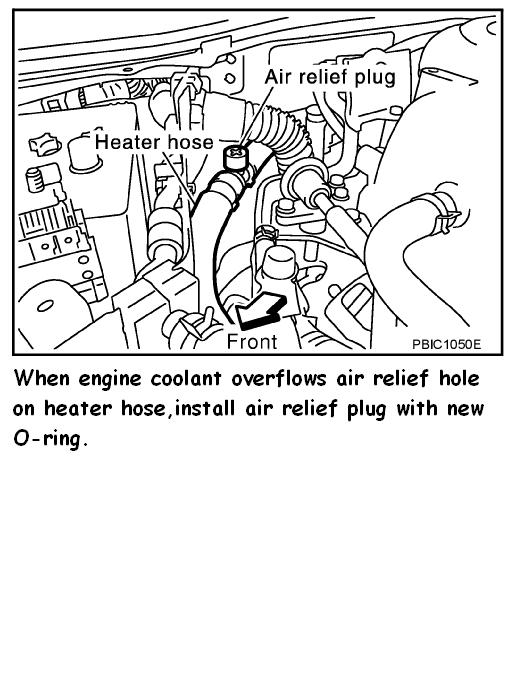

Make sure to open the brethe/burp fitting on the heater hoses between the firewall and the plenum to release the air in the system.
Old Oct 11, 2008 | 06:39 AM
350POWER's Avatar
350POWER
iTrader: (30)
Joined: Mar 2008
Posts: 175
From: S. CAL
what is that? do you have a pic to show where it located? tks

Old Jun 28, 2009 | 04:54 PM
thinking's Avatar
thinking
Posts: 248
From: Right Here
See attached

Anyone here change it themselves. I can only find 2 plugs in the block, I can not find the plug on the left side. The manual says 3, is it wrong or am I just completely missing this thing. I see the right plug, its in the back of the motor and looks like it will be fun to get out.
Old Jul 6, 2009 | 02:31 PM
350ZTheStandard's Avatar
350ZTheStandard
Posts: 9,022
From: NEW AMERICA
It is clearly marked 2 posts above yours, the air relief plug. I opened mine with a phillips screwdriver, just make you don't drop it and lose it. This pic is from the passengers side behind the plenum, by the way new o rings are like $2.75 each.
