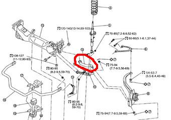

In addition, I've taken my car to the dealer for right side tire pull. My service advisor keeps telling me that the car is allowed up to 8 seconds before it starts to drift. I'll bring the TSB the 3rd time I have them look at it.
No, it isn't when it "starts" to pull to the right, it is that it has completed a left to right lane change in 7 secs.
ntb03046
IF YOU CONFIRM: The vehicle has a tendency for a constant drift to the right on a straight, flat road at highway speeds. NOTE: A vehicle is said to drift, if the vehicle completes a lane change in less than 7 seconds and with no steering correction from the driver and when driving at 60 mph and all four wheels must pass into the other lane during this time (7 seconds) and while driving on a crown-sloped road of less than 1 percent. ACTIONS: Install the right front suspension compression rod from the Parts Information section of this bulletin. See this bulletin for further details.
ntb03046
