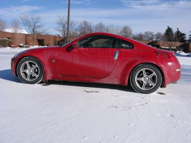

You are good with 225/55-17” all-square. I’ve run this setup on a 2003 Performance model with VDC for many years now and have never experienced a significant issue. I’ve run two different brands of studcless snow tires, and now have Dunlop Graspic DS-2 studless tires on the car.
Here are a couple of pictures ( not exactly "a flush setup"):
Tires:225/55-17” all-square
Wheels: 17x7.5" with 30 mm offset

did you get any rubbing up front with the 55s?
