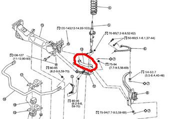

Anybody have a pdf. copy of this one. it's not in the Resources section. I'm starting to notice it happening.

The TSB reference number is: ntb03046
IF YOU CONFIRM: The vehicle has a tendency for a constant drift to the right on a straight, flat road at highway speeds. NOTE: A vehicle is said to drift, if the vehicle completes a lane change in less than 7 seconds and with no steering correction from the driver and when driving at 60 mph and all four wheels must pass into the other lane during this time (7 seconds) and while driving on a crown-sloped road of less than 1 percent. ACTIONS: Install the right front suspension compression rod from the Parts Information section of this bulletin. See this bulletin for further details.
Below is a pic with the part that they replace.

What coincidence. Im starting to notice a slight pull too. Not really when im holding onto the steering wheel. But about 2 seconds after I release hold and the car starts moving towards the right.
