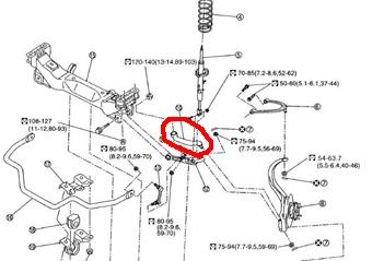

I understand what you are saying but all I was pointing out was that the front end alignment per se isn't why the car pulls to the right. Many people have had alignments done and it didn't correct the pulling problem. The "fix" for the pulling problem is replacing the compression rod with a different one from Nissan
"ntb03046
IF YOU CONFIRM: The vehicle has a tendency for a constant drift to the right on a straight, flat road at highway speeds. NOTE: A vehicle is said to drift, if the vehicle completes a lane change in less than 7 seconds and with no steering correction from the driver and when driving at 60 mph and all four wheels must pass into the other lane during this time (7 seconds) and while driving on a crown-sloped road of less than 1 percent. ACTIONS: Install the right front suspension compression rod from the Parts Information section of this bulletin. See this bulletin for further details."
Here is the pic that shows it:
Attached Thumbnails Z pulling to the right TSB. Anyone have this performed on their Z?-fix-for-drift.jpg
