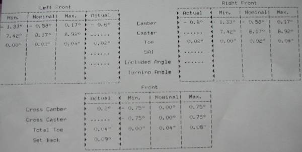

I took my Z to get the Tire feathering Issue verified and here are the before and after numbers. The service manager told me that "It wasn't Bad" . To me it looks "Bad" .They performed the tire swap and sent me on my way. I requested new tires but they told me that they had to follow procedure.
Can someone that knows about alignment numbers let me know if mine were "Bad".
Heres the before:

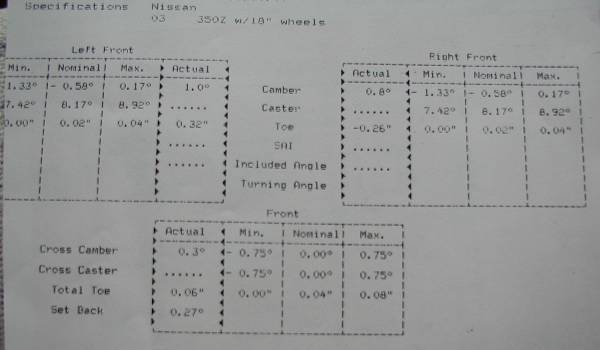

And after,. Also are they using Nissans current specs? They're different then what I found on here.

The "new" numbers are well within specs and are quite good. Your original "toe" numbers were pretty high but are fine now. You can't adjust anything else in the front.

PS. the specs they are using are current
