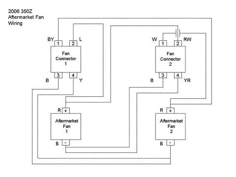

Just changed to new Spal electric fans instead of the OEM setup.
2005 350Z started throwing PO300 code - random misfire.
Everything seems fine while driving.
Any chance the PO300 code is being caused by the new fan setup?

I did rewire (see photo) according to this thread:
https://my350z.com/forum/engine-and-...ator-fans.html
This was only the fan circuit wiring not the main harness.
No one mentioned throwing a code.
I was wondering if the extra amp load would possibly cause the PO300 code.
Car runs fine and no problem with idle.

I just though of something while i was trying to diagnose my P0300 code. My rough idle tends to get worse every time i roll a window up or down. So I'm guessing I have a ground fault issue somewhere.
Have you checked for proper grounds on you wiring? If its not touching bare metal its not grounded properly.
Also to accomodate for the added current draw when the fans kick on you could wire in a relay. A basic diagram for that is available at the12volt.com
