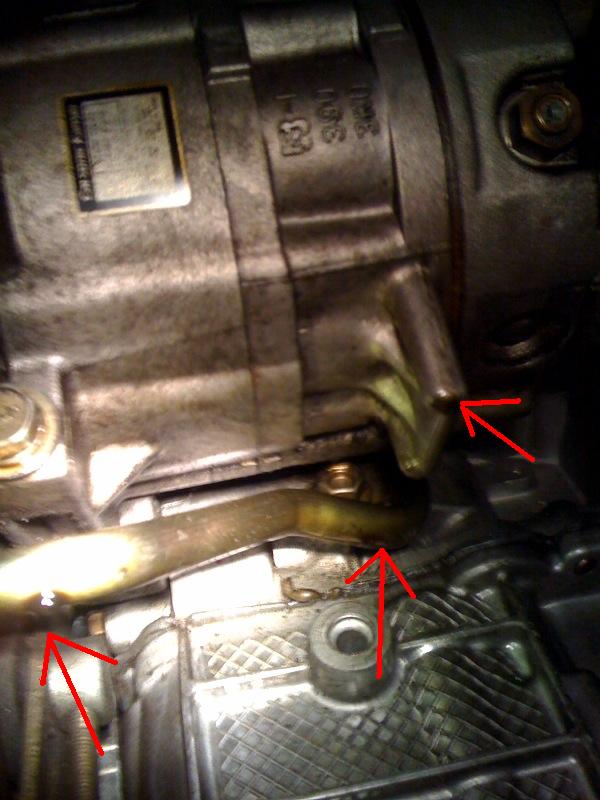

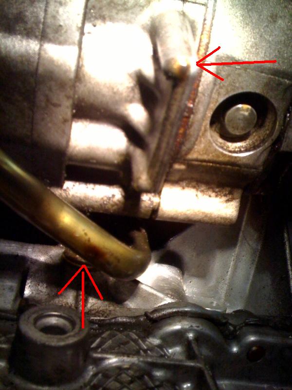

I noticed during my last oil change that the left side of my car was dropping trace amounts of oil on the floor. Its not much at all, almost like a few drops at most if the car was sitting for a couple days.
Last night (after I took these pics) I took some simple green and degreased the motor to see if this might just be some residual oil from checking it with that awful dipstick we have. At any rate, I cant seem to tell where this might be coming from. Does anyone have any ideas? It looks like its dripping off the A/C condenser.
edit... Motor has 45K on it and I cant see anything leaking from the top.

Minor update. Drove the car yesterday after cleaning the engine, got on it a bit and let it sit in the garage last night without the cover on it. It sat for about 10 hours and nothing has dropped to the ground. I wonder if maybe some oil is being pushed out of the dipsitck...
What a PITA...

update... I dont have an oil leak it was all residual oil coming from that crappy dipstick we have. All is well!
