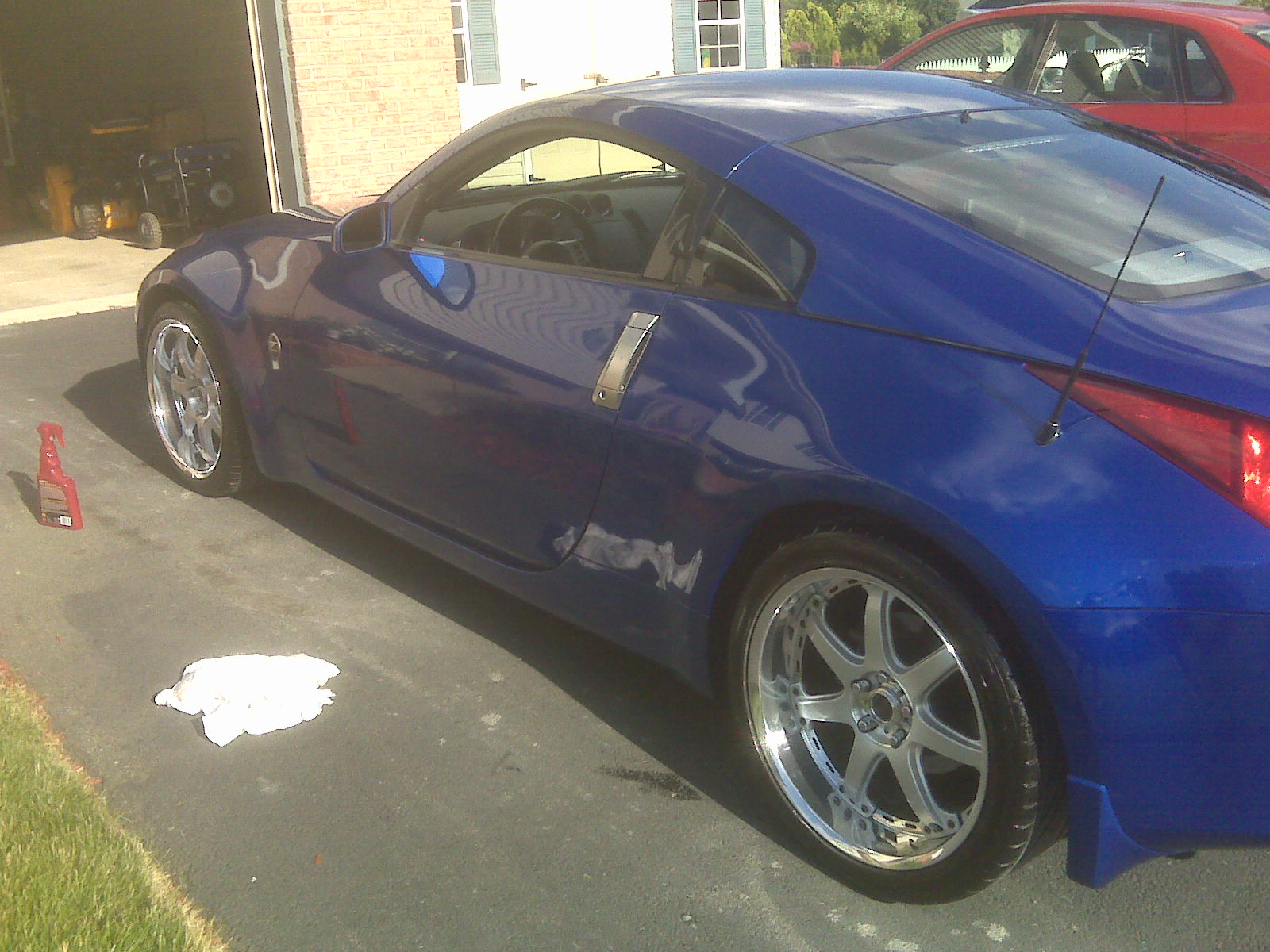

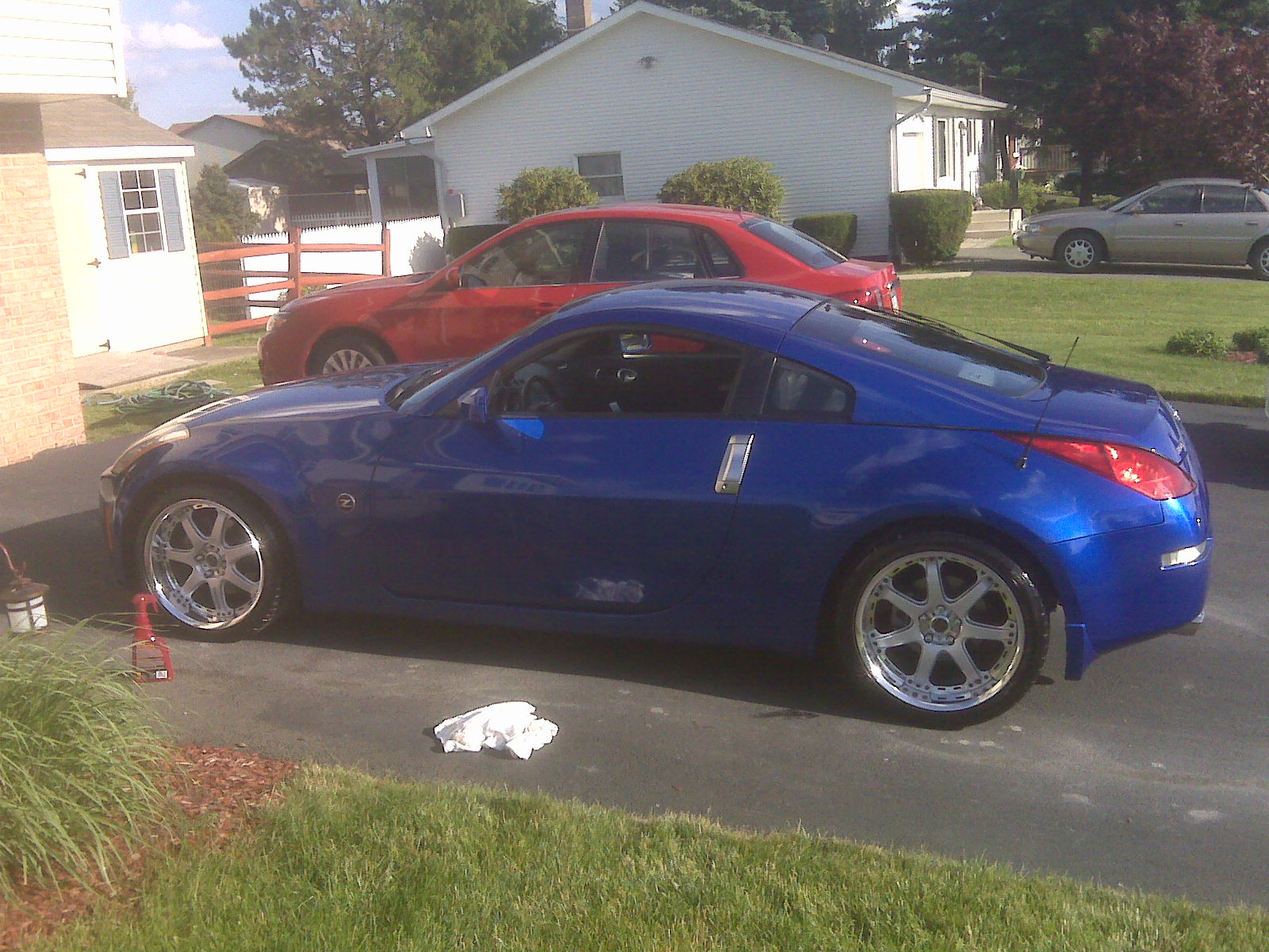

I now have a 05 Touring (exact same as the 2003), Manual, Volks, Bassani Exhaust, Intake, for the most part factory except for the bolt-ons. It has 63k on it I bought it with 15,400 miles and it still has the factory clutch. The clutch has a very loud noise from the throw out bearing while the clutch is not engaged and when the clutch is engaged it goes away. I have had the noise for about 15K but the clutch never slipped. I just dealt with the noise as I have discovered it is a common issue. Over the past week or two the clutch is starting to slipp so I know this needs to be replaced. I am trying to decide on what brand and stage since I want to s/c in a year or two. I will schedule the appt with my mechanic in a few weeks and he will probably do some type of coil-over as well. I recently bought the Volks and I know it needs to be dropped.
I added some bberry pics and they aren't that great but you get the idea. I know I need to get a short antenna and new lugs.
