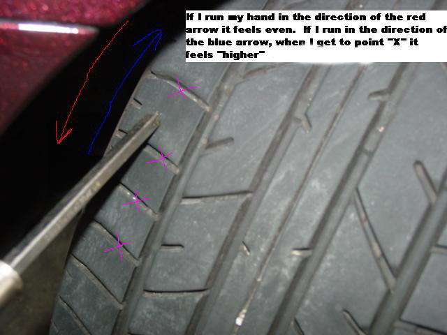

The inside tread of your two front tires are wearing unevenly.
If you are squatting in front of your DRIVERS side front wheel (with the steering wheel turned to the left so you can see the contact surface of the tire). Run you hand along this innermost tread pattern in a clockwise direction (i.e. toward the rear of the car) and it will feel rough.
Now do the same thing but this time run your hand in a counter clockwise direction (i.e. toward the front of the car) and it will feel smooth. The best analogy I have seen written (sorry but I can't remember who wrote it) said that it feels like petting a cat backward toward his tail (feels smooth) and then toward his front and against the grain (feels rough).
Attached Thumbnails Could someone explain Tire Cupping and Feather in laymans terms or with pics-tire-feathering-copy.jpg

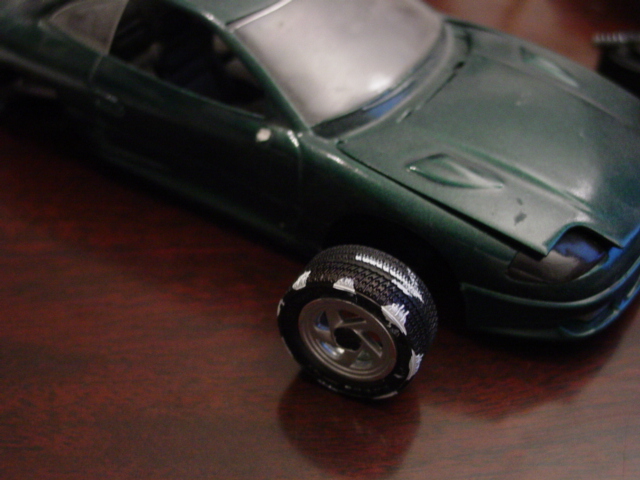

Sounds good Doc, What happened to that little green model car you used to use for the rotation TSB demo...I liked that one...That was you right?
Think of the tire tread looked at from the side to look like saw teeth /] /] /] instead of the flat [] [] [] blocks
Put it this way, if the tread looks even and flat on the inside and the same as the outside you're probably OK...

Yeah that was me and my little Green Stealth model. I was demonstrating the front tire swap TSB for feathering.
