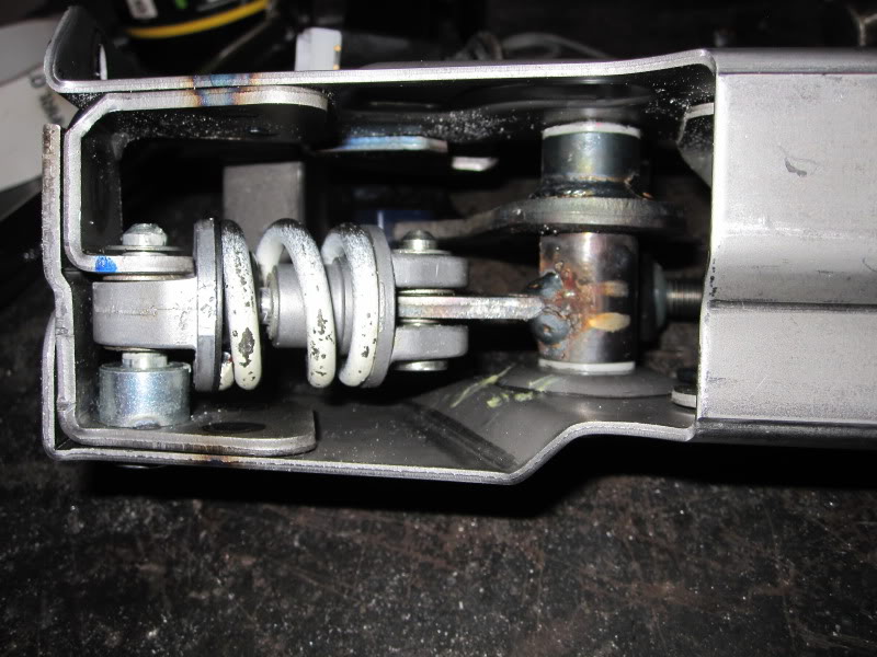

I fixed my popping issue. My problem was in the spring assembly attached to the pedal. Liberal application of grease to the spring assembly. There is a sort of shaft that runs through the spring. I slathered that up as well. My ribs hurt for a week after contorting up there but the pop was gone. BTW you have to prop the pedal to the floor to really get at everything.
A picture. (I hope the OP doesn't mind)

I would hate to see you go though all the trouble. I've had two 350Z's that had a popping clutch pedal. The first one I just ignored. I traded it in. This one I intend to keep so I wriggeled my big a$$ up in there and lubed it all up. It was a small price to pay for the buttery smooth clutch pedal I now enjoy. Sure the clutch pedal still sticks half way down and burns when I try to really burn the tires off but I think that is another problem.
Maybe your problem is inside the bell housing somewhere. I would hate to see you spend all that time and money and end up with the same problem. I would lube that joint up first. Hell, if I could pack that whole area full of grease I wouldn't mind. Maybe I should invent something to do that.
