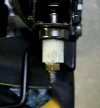

Progress report: Took seat motor apart and discovered tooth from nylon gear jamming the motor's metal worm gear.
Cleaned motor and tested it. It appears to work fine in both directions.
Can anyone get me this gear in the picture below:
