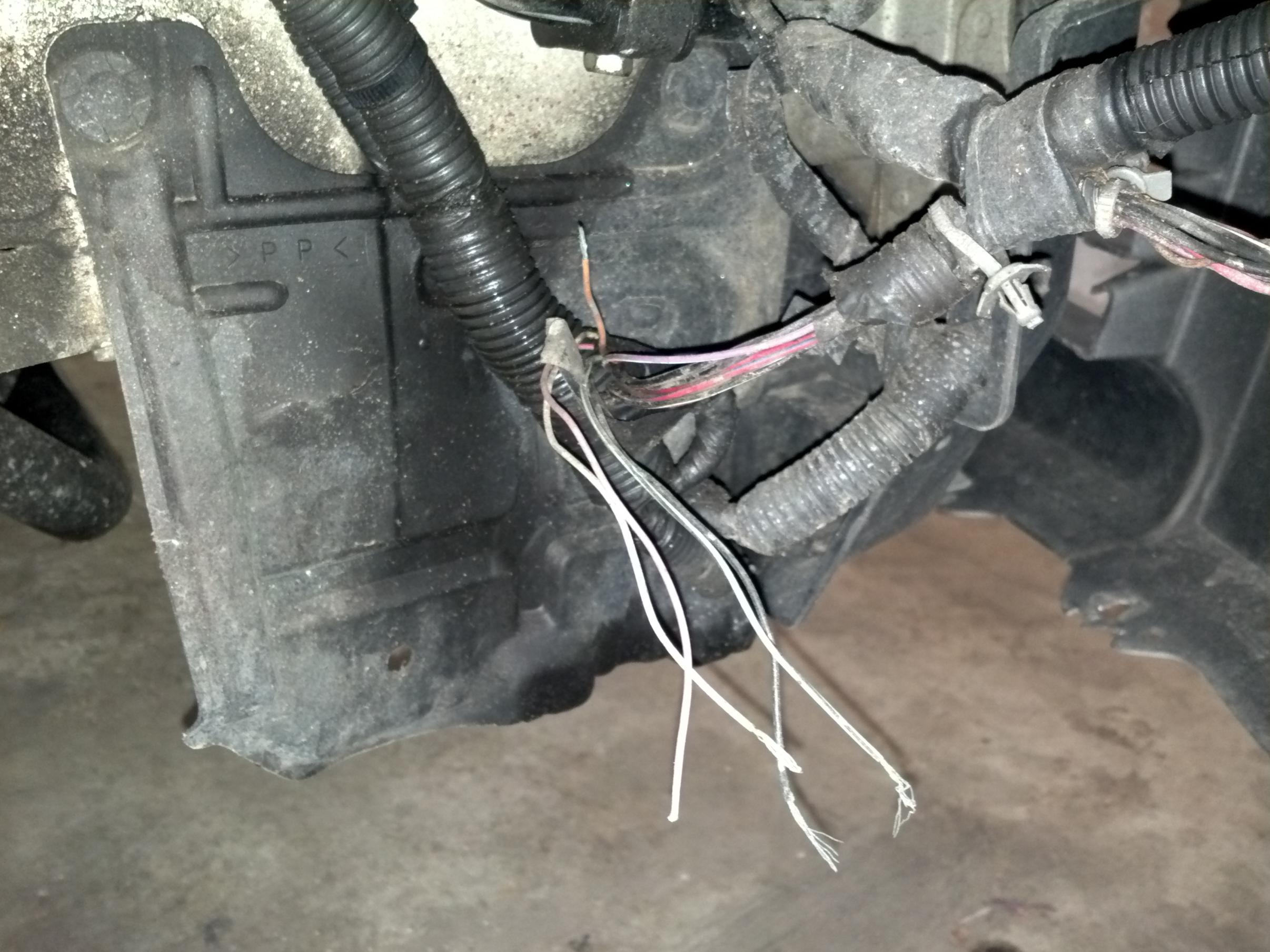

Hey Everyone,
So i just bought my Z (03 with 50k miles) And before i do any serious driving I'm going through everything (brakes, ball joints, bushings etc..) to make sure its all in good condition. Everything seems fine except for these 4 wires that are frayed and split in the passenger side wheel well. I am not sure what they go to so I was hoping someone could tell me or help me find the answer. One of them is green, one is pink-ish (prob suppose to be red) one is white and one is black. Please feel free to give me any advice you have. thank you all very much.
-Levi
oh and btw sorry if this is in the wrong spot, feel free to move it if it is.

Look like wires for aftermarket lights.

I though about that but I figured after market headlights would use the same wires as oem (maybe im wrong). They are in the same wire bundle though. thanks for the advice.

Not certain what the previous owner attempted. Lighted side markers or running lights? If your lights are working properly clip the wires.

do you have a washer fluid tank? There are two solenoids and a float switch on it.

Yeah i have a washer fluid tank, never actually checked if it worked though. I will do that tonight when i get home. Thanks fro the advice
