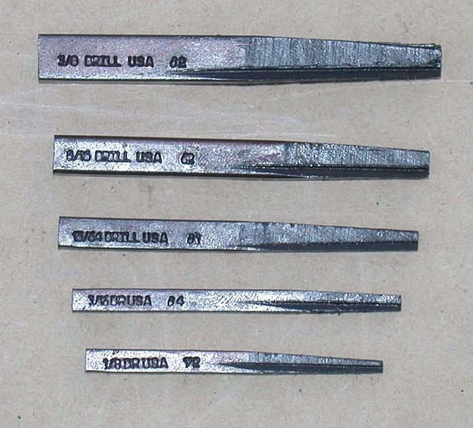

drill a hole right through the center of the broken bolt. hammer in a squared screw extractor and use a wrench to turn it counter clock wise, it should come off
Attached Thumbnails Undertray Bolts Broke... FML-663px-screwextractors-square.jpg

Pick a bit that is smaller than the screw shaft. drill a centered hole like stated above. From that point, you should be able to use a screw extractor.
