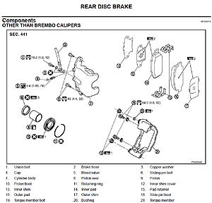

wheel bearing hub bolts (ones that bolt to the knuckle) - 65 lbft
rear axle nut - 177lbft
brake caliper - 53-71lbft
brake caliper housing - ???
