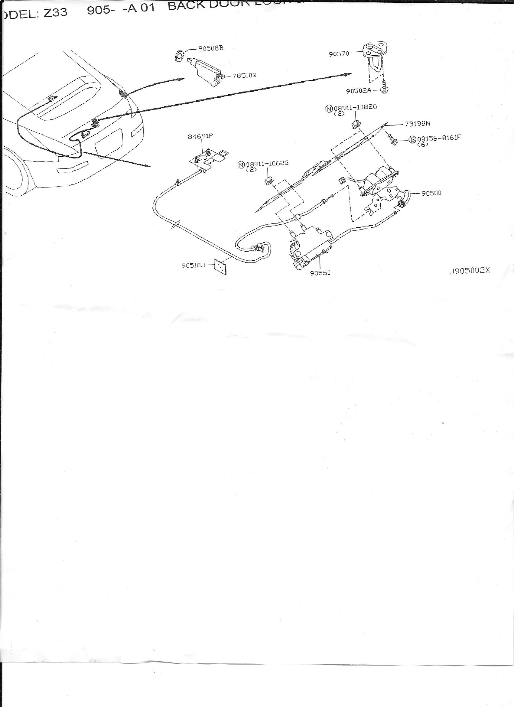

Which part is use to unlock the trunk

# 90500 is the lock assembly, 90550 is the electric solenoid that pulls on the lock to open it and 8469 is an inside cable operated lock opener.

# 90500 was the part that I replace and trunk back to normal
