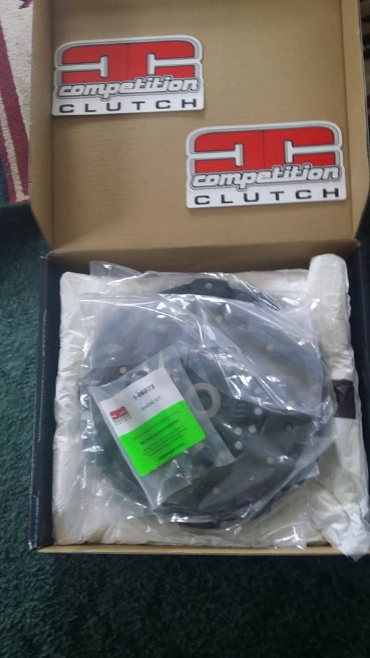

My old clutch is dying and getting ready to drop it off today. Is there anything else I need to change when dropping a new clutch??
Attached Thumbnails Dropping a Stage 2 Clutch-10492326_766690100019904_4588012840823207353_n.jpg

If you drop the clutch you'll probably have to replace it again. Hard impacts are not good for them.
What is a stage 2 clutch anyways?
Is there a chart that shows the specs for all these unknown stages of clutches?

Anyway, I'd certainly look into replacing all the hydraulics, and if it's a HR car, no way I'd keep the OEM slave cylinder in place.

I thought there was different stages in clutch and speaking of slave cylinders...
I replace my slave cylinder THREE times and they all came from a dealership.
This is for a 2007 350z and changing a slave cylinder in those required taking down the transmission....
