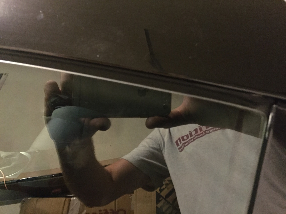

Another question I mean tot ask, thanks for reminding me, it seems like my window may be misaligned just slightly (see images attached - note: both photos taken with door slightly open)
You'll notice at the front of the window, it is very close (barely brushing the trim piece when closing) which makes me thing it's a bit higher than it should be. And the back of the window looks to be a bit lower than it should be...
I had a 325ci where the windows would roll up/down when opending/closing the door and I had the adjust the position of the window for the same reason, being too high in the front, too low in the back. Is there an easy way to make that sort of adjustment for the windows on the Z?
