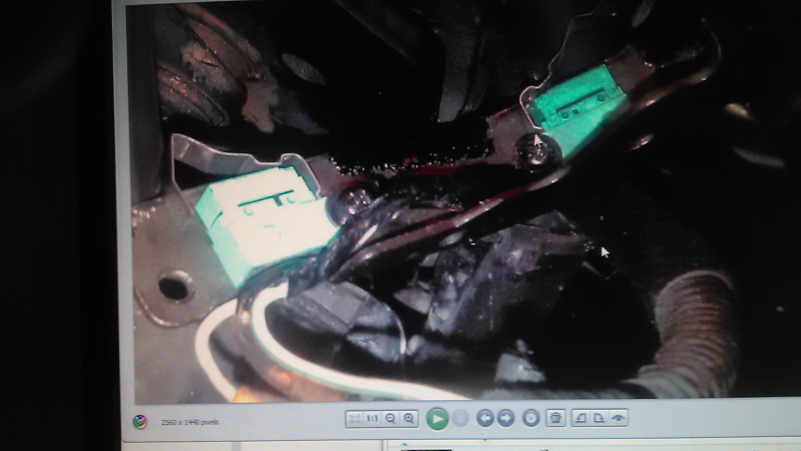

for those that have a convertible and it does not work , as mine , I first changed 5th bow motor , disappointed , but alas , after further looking emptied trunk open top and wow there was this switch mounted on pivot point by driver side two switches , one with lever bent out of shape see pixs ,now works [ATTACH]375619[[ see levers one bent out of shape. hope this works for u

I cant find the part number to purchase it. My switches only have one metal bracket. Thanks.
