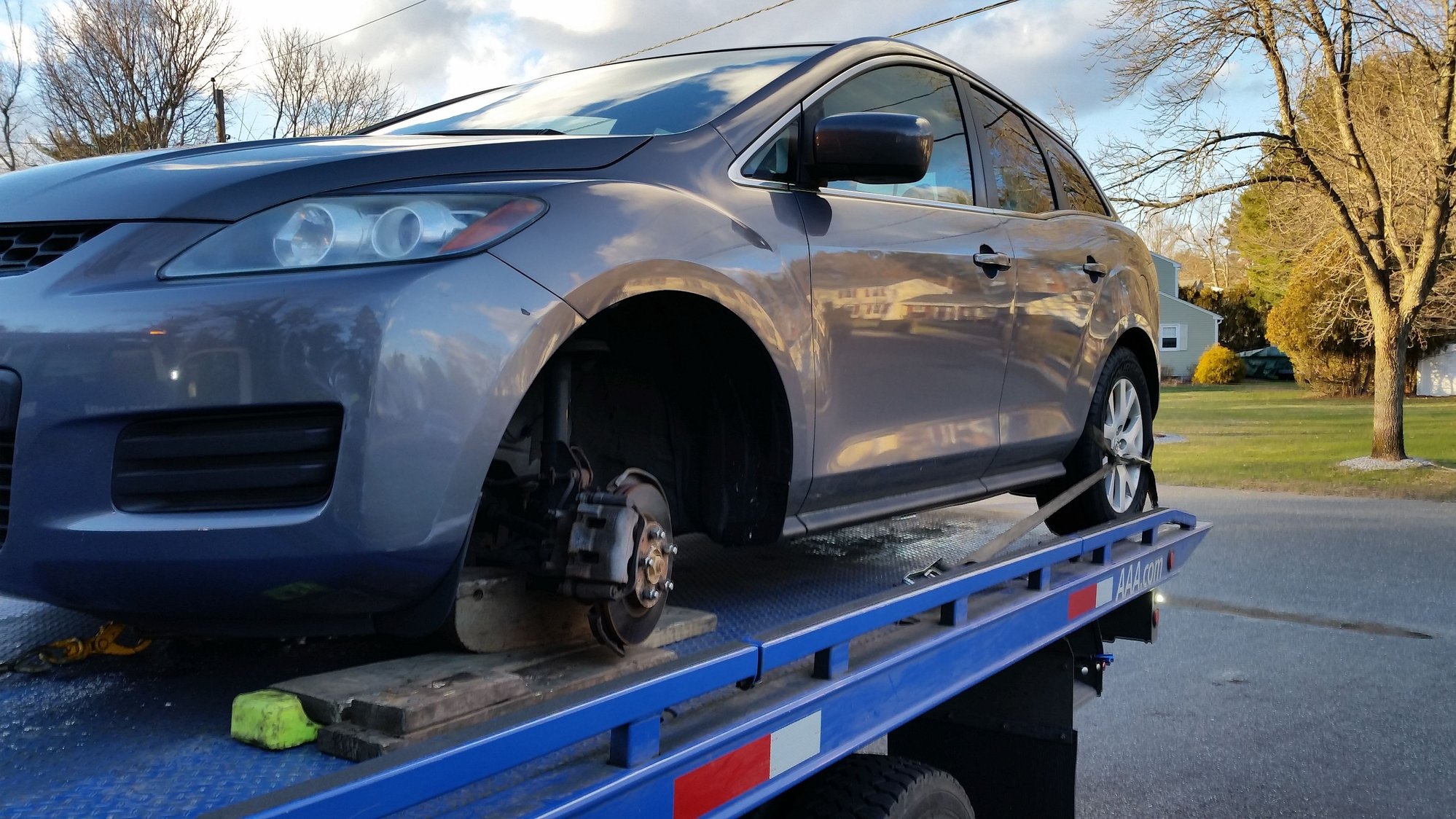

Dont be like this guy... Not good for anyone.
Lost a lug didnt he?
Lower ball joint broke, I was just nice and removed the wheel so it wouldn't go flopping into the fenders... When lug nuts are loose and the wheel falls off usually you can put it back on and its easy to load...
Unless its like this sweet ford
