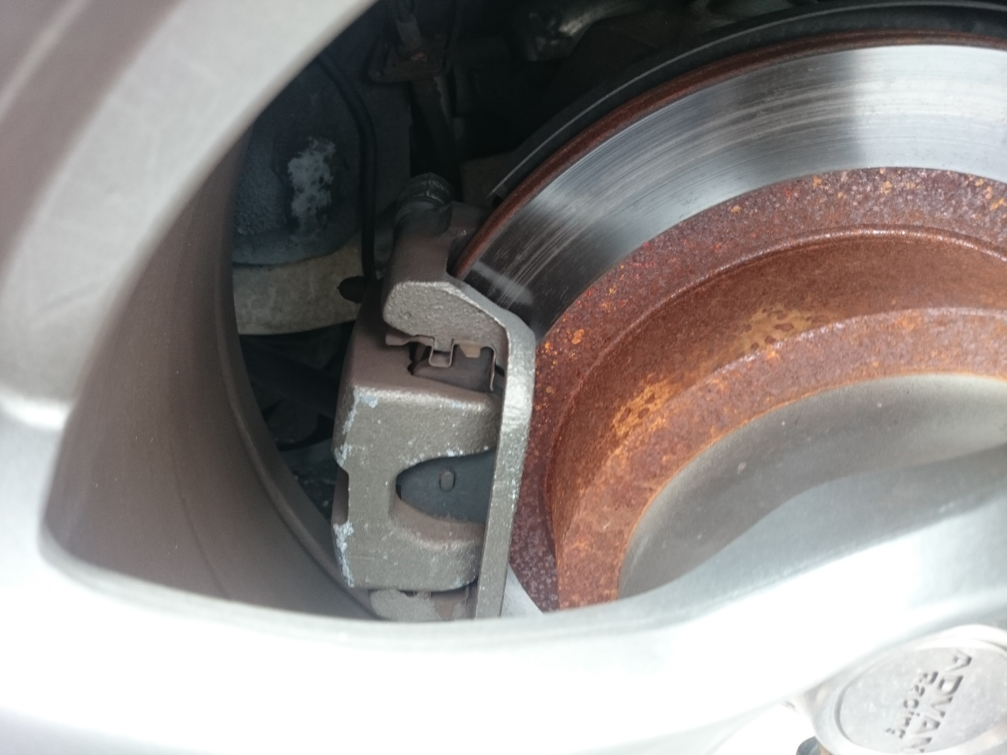

Can anyone tell me if these brakes/calipers are OEM? They don't look like anything special but the car is new to me and idk what the originals look like. Pics attached. How do I know if my calipers need to be replaced too? I was going to measure the rotors, but the rear set is pretty rusty and i want new ones on there anyway.
Also are these a good replacement? I wasn't planning on getting drilled or slotted but these are a good deal for the set ya?

That is oem base goodness right their...

You have factory non brembo brakes.
