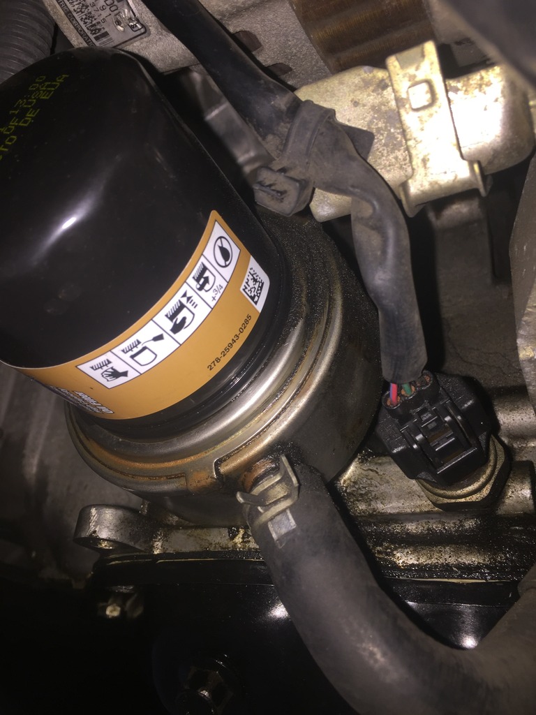

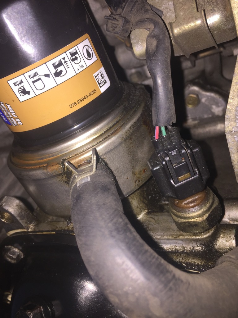

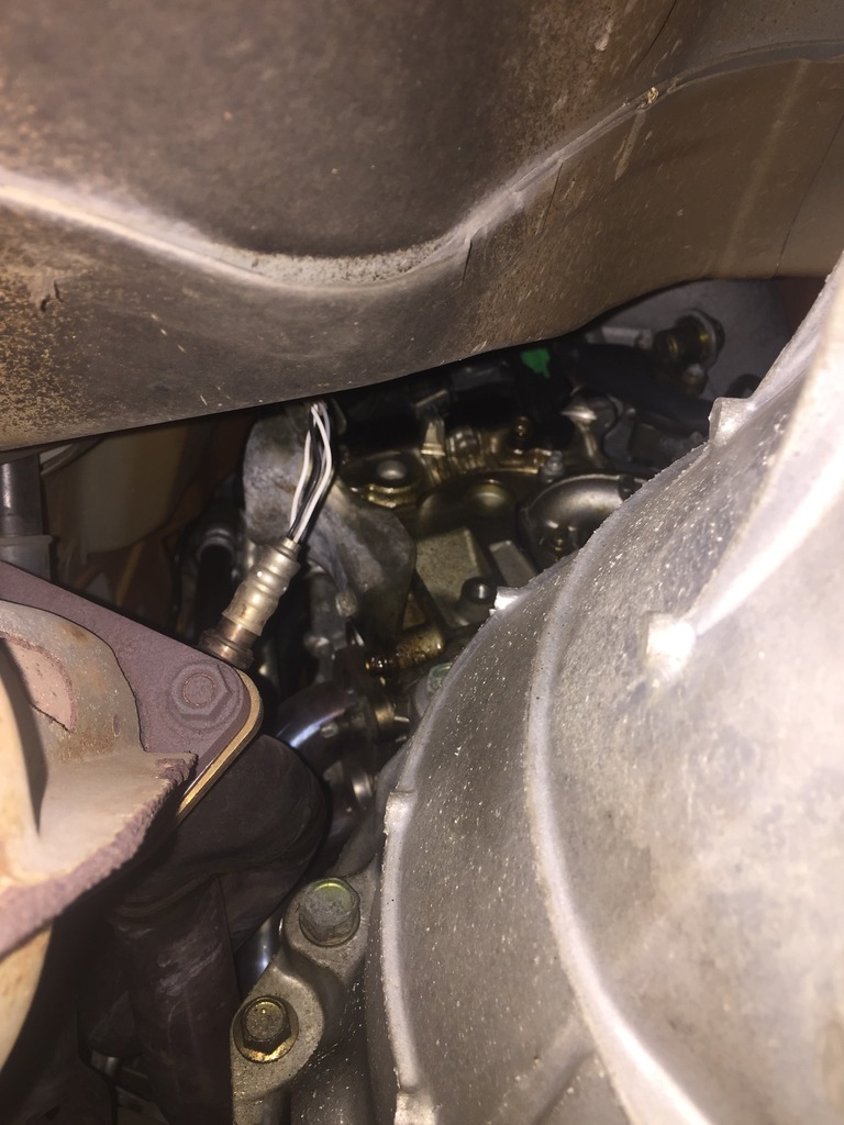

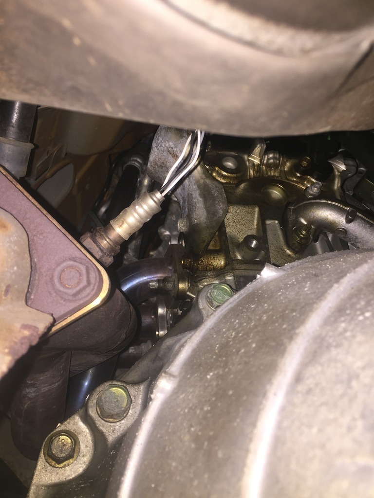

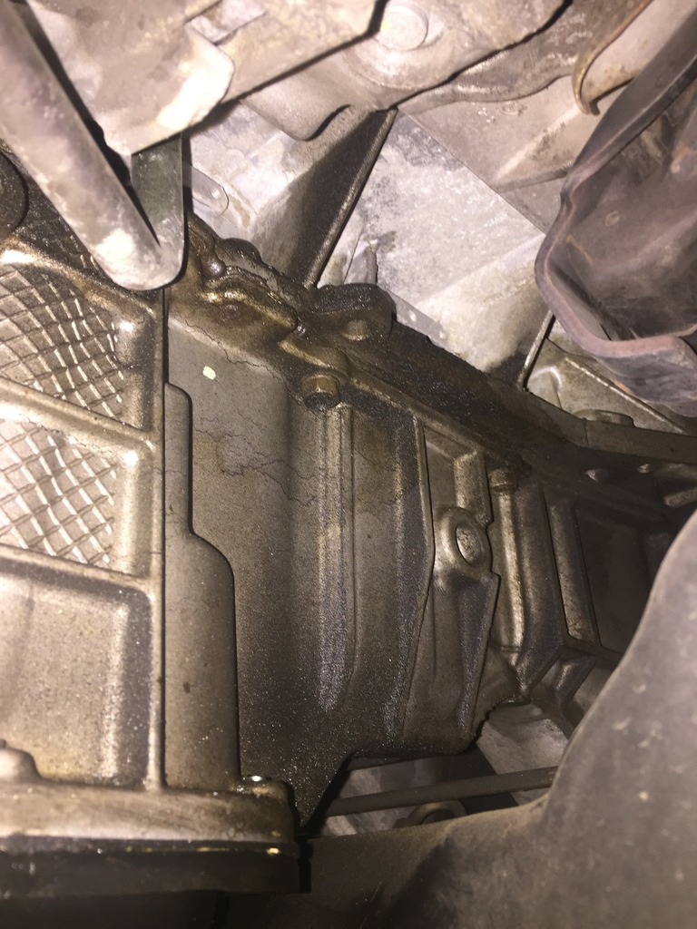

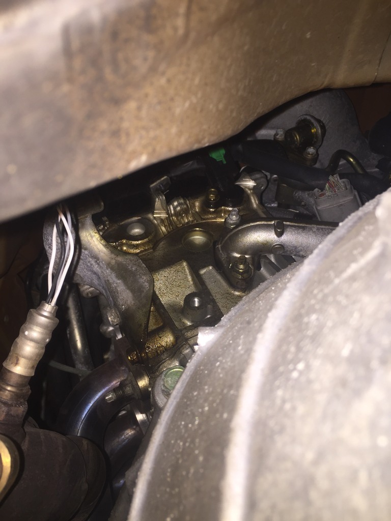

So I purchased a Z a couple weeks ago for a pretty good price. (thought so at least). I went to change the oil the following weekend and noticed what looked to be a lower oil pan leak. So i changed the gasket ad thought I had it fixed. Well a couple mornings after I noticed a very small puddle of oil under the car. So i finally got the car on a lift today and took some pictures.
First off, the car is an 04 6mt with 119k miles. Want to also mention i noticed the spark plug seals are leaking as well when changing the plugs last night.
Where i noticed it was most wet

I can't see where the leak is from the pics, but the grime on the plenum is just blowing up from below. Best bet is to get the engine completely clean, and then look for the source. You might even try some UV dye in the oil.

The oil cooler, under the filter, has a gasket that leaks, which looks like yours is.
The oil on the back of the head is either the valve cover gasket, or the cam position sensor seals, which are very common VQ oil leak sources. Change both anyway if it's my car, neither is terribly expensive or a big deal. The cam sensor o-rings might be hard to find separate, but if you remove them and match up new ones you should be fine.
The oil on the top could be residue from spillage on oil changes (it doesn't evaporate so it collects dirt) or you could have an oil cap that isn't sealing well and allowing vapor to blow out onto the manifold. That one needs to be cleaned well and see where the source is.

as stated above i would clean up all the oil with. I've had this issue and cleaned the mess by buying 3 or 4 cans of brake cleaner. Brake cleaner is the best degreaser IMO for metal parts. I'd spray the top of oil pan, sides of the block where you see oil and around the oil filter. brake cleaners cleans right up in seconds.

ALSO i know for sure i have a leak behind the engine at the camshaft position sensor. those sensors have a gasket on them and over time they can degrade. I was able to see that leak when the car was on a lift looking directly up, nothing is needed to be removed to see that. Check your PCV to make sure its not clogged or defected also.
