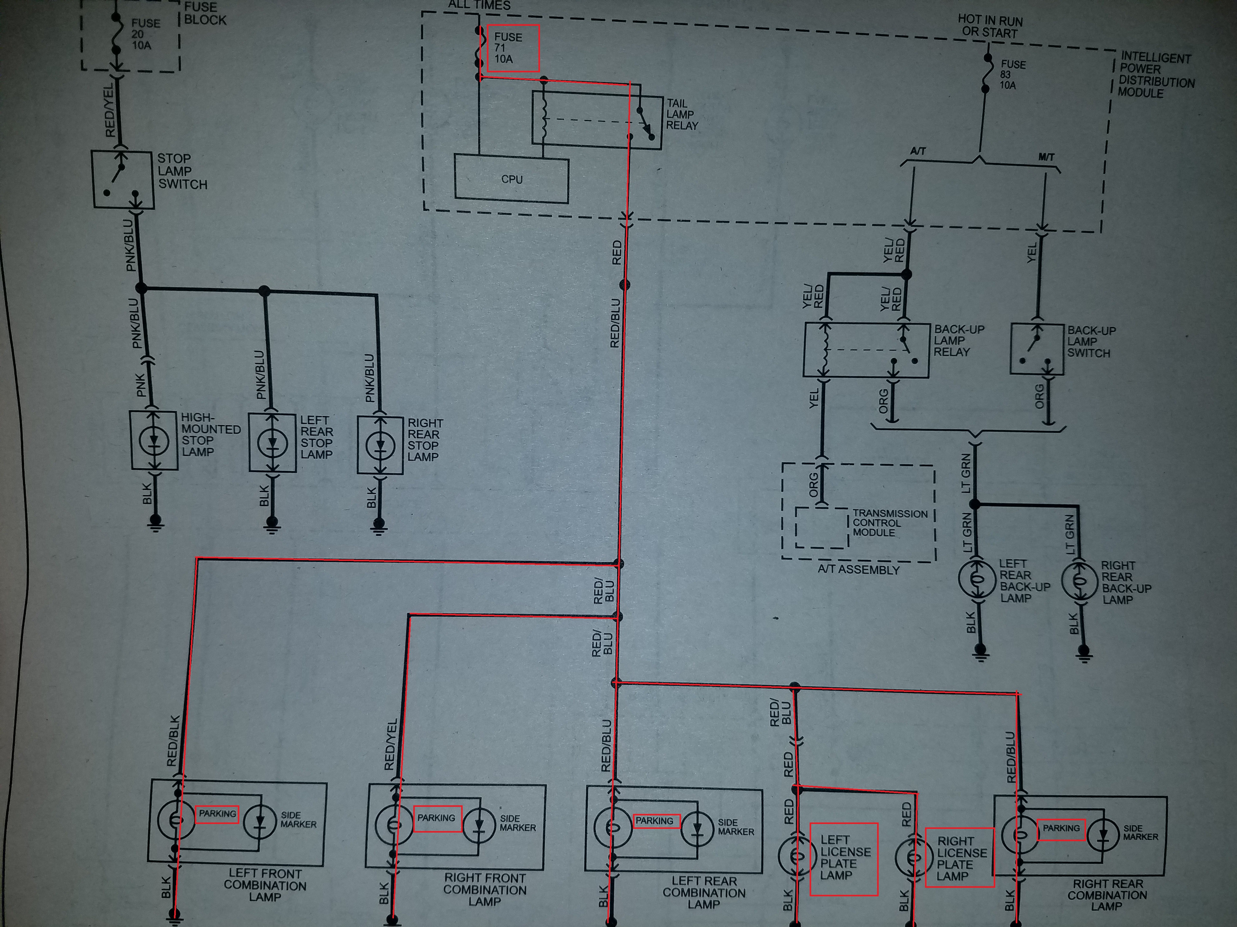

Does anyone know where the license plate light fuse is? My license plate light and parking lights don't work. Everything else such as my brake lights and indicators work. I found the taillight fuse but tested it and it works... Is there any other fuses that run in that circuit?
The car is a 2008 350z

Unfortunately it's not in the owners manual, so if it's not indicated in the fuse box cover you have to download the factory service manual and find it that way.

I went the extra mile just for you and broke out my book and even made it dummy proof for you:
Wiring Diagram

I had to pull the "taillight fuse" which was hidden underneath the battery cover. So I had to remove all the plastic covers to see the third fuse next to the battery. My friend used his multi-meter yesterday to test the fuse and it showed that it was working... Today, I decided to pull the fuse just to see it and it was in fact BLOWN. I replaced with another 10a and VOILA! My parking lights and license plate light all worked again!
Weird thing is... The multi-meter showed that it was receiving power... Lesson learned, NEVER TRUST THE MULTI-METER! PULL THE FUSE!
Thanks for your help!
