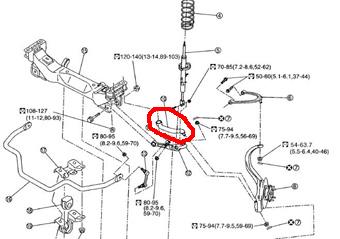

Here is a copy of the TSB for the pulling to the right:
ntb03046
IF YOU CONFIRM: The vehicle has a tendency for a constant drift to the right on a straight, flat road at highway speeds. NOTE: A vehicle is said to drift, if the vehicle completes a lane change in less than 7 seconds and with no steering correction from the driver and when driving at 60 mph and all four wheels must pass into the other lane during this time (7 seconds) and while driving on a crown-sloped road of less than 1 percent. ACTIONS: Install the right front suspension compression rod from the Parts Information section of this bulletin. See this bulletin for further details.
Below is a pic of the part they will change to supposedly fix it. Make sure they do a full four wheel alignment afterward. This should be done free of charge.

Did you get a FOUR WHEEL alignment afterward?
I got the TSB and the alignment and while it still pulls slightly to the right, it now takes like 12-15 seconds to make the lane change instead of the 5 seconds it took before.
I also got the tire swap TSB for feathering (actually for "tire roar") and it stopped that as well. I have had about 4k miles on it since then and no feathering yet but it is still kind of early.
