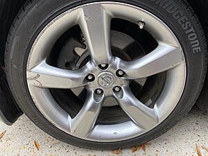

I curbed it at some point. Want It nice again
1. Paint? Color code? I could do it if I can get matching paint.
2. powder coat. Would be the toughest. But can I make it match?
3. Replace. There are some available. But expensive. If I could find used but great condition. It would be perfect.
It’s a 18x8 by the way

You curbed that wheel pretty good. I'd send it off to a wheel specialist in your area. Have them check it for runout and straightness on both the inside and out- if it's too bent, there's no use in spending any more money on it. But if it's repairable, a good shop can clean and polish it back.
