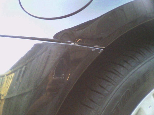

hmm heres the pic

The Ding King or whatever you use will not fix a dent with a crease. It can make it better. I got everything out but the small crease with the puller after around 15 pulls. It takes around 10 minutes a pull to wait for the adheasive to dry, etc.

I have a similar dent as you beaker02.. only about half the size tho.. the results look promising... i may have to give this a shot b4 i spend $120 on PDR's.. thanks for posting results

I got mine (after 20 pulls) to barely noticable. I have to point it out to people now. For me, $20 well spent. Remember.......It only makes it better!

Beaker02, For all that effort...a quick call to a Paintless Dent Repair outfit (like the DentWizard) and about $50 would have made that dent disappear in about 15 minutes. I've used them on all of my vehicles (with the exception of the Vette -- fiberglass) and they can work miracles.
