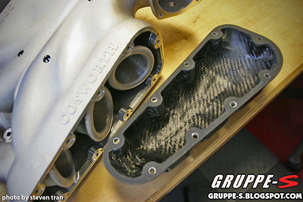

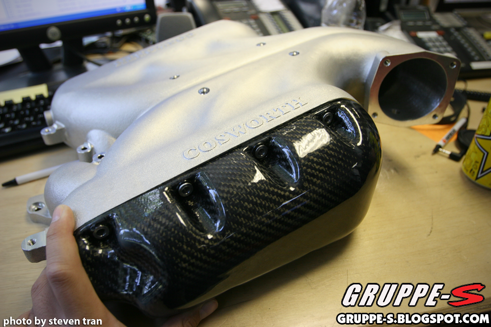

This just came in the mail straight from Cosworth USA, the Cosworth Nissan VQ35DE Twin Plenum Intake Manifold (PART #: 20000063). The Cosworth Twin Plenum inlet manifold for the Nissan VQ35DE has been engineered for increased performance featuring increased plenum volume for improved high rpm power with torque enhancing velocity stacks to maintain mid range performance. With performance derived from countless hours of development including computational fluid dynamics, the Cosworth Twin Plenum Inlet manifold is perfect for both normally aspirated and forced induction applications. Performance increases will be significant on engines with improved exhaust and intake system including optimized ignition/fuel maps with increased maximum rpm limiter. Cast from lightweight aluminum alloy with carbon fiber end caps and includes all required mounting hardware.

It is going to be pressurized, Dyno results should be up in the next week or two once we get a chance to break in the new motor and tune it.

Just to clarify for everyone, it is a 2009 Nissan GTR R35 that we are building as part of the Gruppe-S / Hankook Tire Drift Team. It is a full competition vehicle that will be driven by Robbie Nishida for the 2010 Season of Formula Drift. it is a VQ35 from a Z that is stroked with a custom BC Kit. It is going to FI, more specifically Turbocharged, and I'll have photos of the custom turbo setup very soon, most of the setup is already made and on the car.
