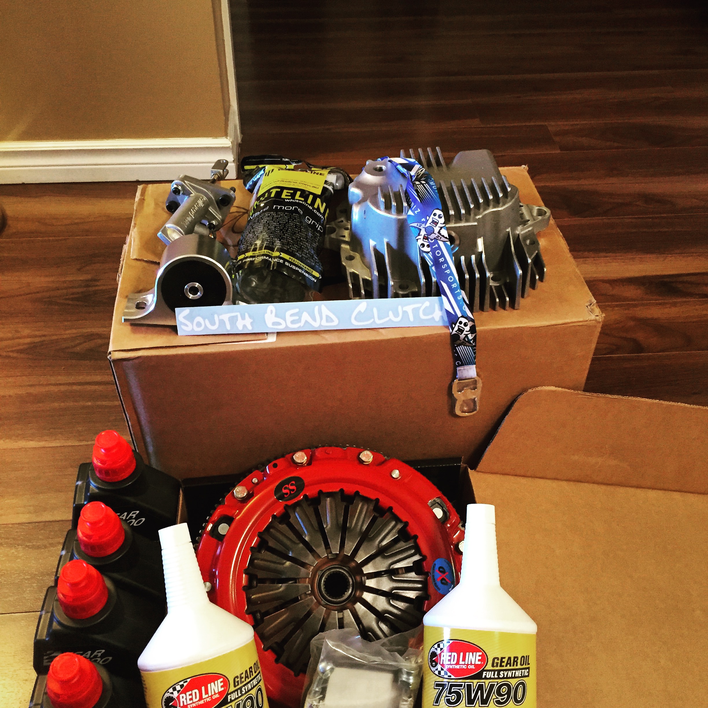

So as of 2017: I have had the car retuned on a dyno to get it dialed in a little better as I noticed it was running a little rich and was hesitant at the 2500 range. Those issues are now taken care of.
- Ive installed a southbend and flywheel combo with the wilwood master cylinder/new oem slave and all stainless lines. Big difference in the feel with this combo since my bullydog/fidanza setup.
-Ive installed all new whiteline differential bushings, the car feels alot more solid and 100% worth the cost/install. The install was easy but time consuming. I viewed many different ways on how to remove the old bushings and install the new, I literally drilled out and recip sawed the old ones out and rigged up my own puller with threaded rod/nuts/washers to get the new one in. As I drilled out one of the bushings, one of the pockets blew up and oil went everywhere, all over me, the garage and anything else in the vicinity so cover them with a rag if you drill them.
-Ive installed the z1 transmission mount, shifting feels alot more responsive and I would definitely recommend it. The install was simple to complete.
- Ive since attempted to install z1's motor mounts, it was a bitchhhhhhhhhhh of an install to the point where I didnt complete it. It was way too much work for what it was worth to me especially when there was nothing wrong with my current mounts. I'll throw them in if I ever pull the engine.
- Currently I am waiting for a motive power bleeder to arrive to install my stoptech BBK that Ive had sitting around collecting dust. I finally have time to do this install so Im excited! I'll throw up a review once those are on.
- Oh and Ive installed an INGS+1 lip which fit perfectly right out of the box.

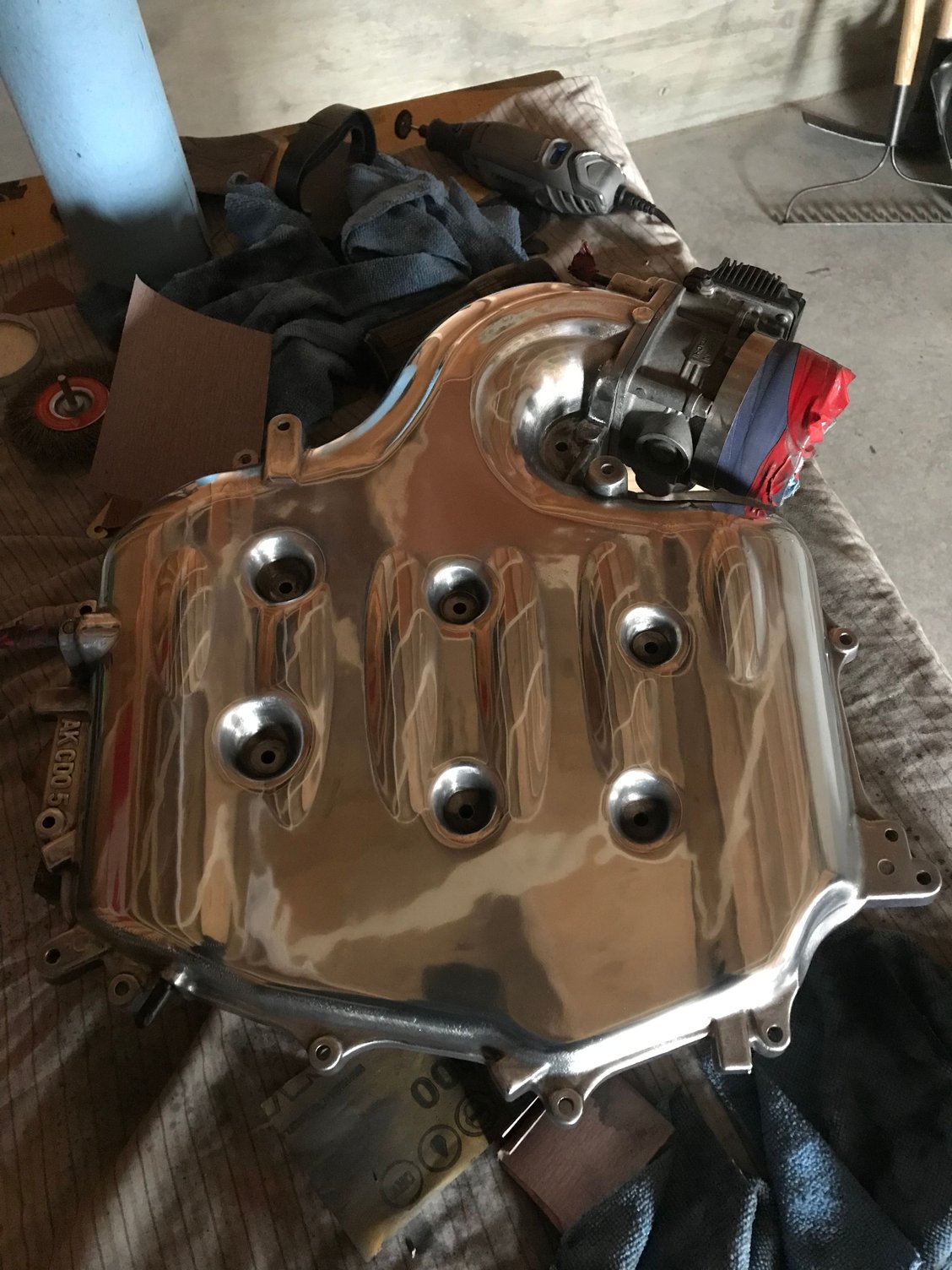

I just finished up polishing my plenum. It wasnt as bad as I thought it was going to be. I read a few DIY’s that said it would take 18-20 hours but it only took me about 6.
Before:
Heres what I did:
1) I used a strip wheel on my drill first to remove the corroded layer and any pitting. I also used a wire wheel for areas the strip wheel wouldnt reach
2) I used a small wire wheel on a dremel to get into the tight areas to remove the corroded layer
3) I used 120 sandpaper on an electric palm sander to remove any deep scratches I had put in the plenum by the strip wheel and sanded by hand for any tight areas
4) I moved up to 180 grit on the palm sander, then 220, 400 on the entire plenum
5) I started wetsanding using 500 grit sand paper, then wet sanded using 600 and then finally 1000.
6)This is the stage you should see some major differences, I used Mothers aluminum polish on a lamb s wool buffing wheel on my drill and polished the entire plenum.Any tight areas I used a soft polishing wheel on my dremel with the aluminum polish. Anywhere I couldnt reach with the palm sander or dremel I did by hand with a microfiber cloth.
Keep in mind I polished the main face of the plenum and the sides. I not did go to major detail with the edges of the plenum because it would take foreverrrrrrrr to do it all by hand without the palm sander. This is most likely where guys took 18-20 hours and I only took 6. I still cleaned everything up as much as I could but not to the depth of what I did to the main face of the plenum. Youre basically just sanding out the previous scratches you had made from the previous sandpaper. Each grit you increase by you will notice it get smoother and smoother. It worked out very well, hope this helps someone in the future!

I paid a shop 100 bucks to do mine and you make it look so easy. That looks really good.
Old Jun 21, 2018 | 04:20 AM
crd00's Avatar
crd00
Joined: Mar 2012
Posts: 112
From: canada
Thanks man! Only cost me about $5 in sand paper, $10 for the strip wheel and wire wheel(clearance at walmart lol) and I already had the aluminum polish and the microfiber cloths. The labour is what youre paying for but I didnt mind it at all!
