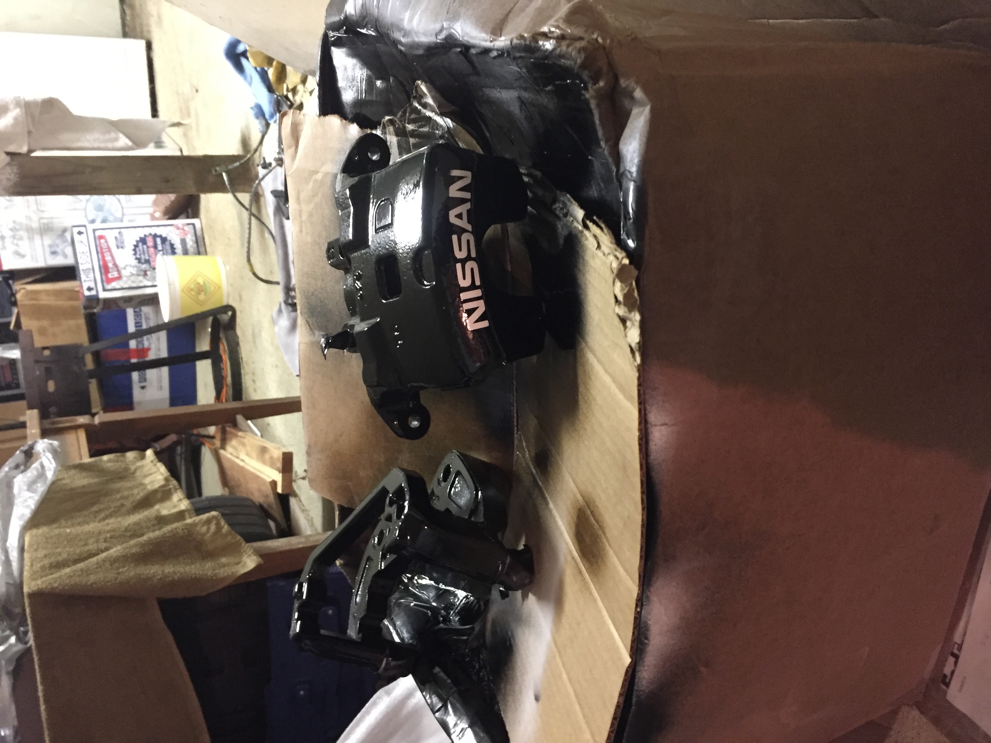

A week ago, my left rear caliper's piston got stuck. Decided to replace all 4 corners because I figured if one goes bad, the rest will eventually too. Bought a set up from a forum member on here. I decided to paint them black because little red calipers looks a little ricey to me haha.
My process was brake clean > 180grit sand > brake clean > 400grit sand > brake clean. Then VHT primer > VHT black > Nissan decal > VHT clearcoat.
Here is the first caliper that I finished
Thoughts and comments?

Looks better than red

with being black they wont scream... hey, look how small and cute i am.
honestly, you did a good job on them

They look nice, OP. Tastefully done.

Decal is a bit much for stockers, but clean regardless.

Whoa! My oem calipers didn't come with a Nissan logo from the factory tho?! Da fck?????

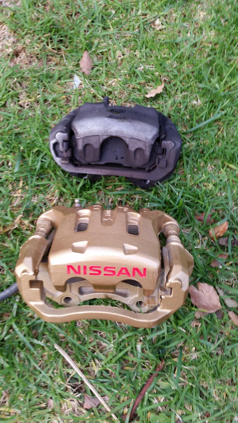

Looks good. DeusExMaxima did something similar with his, with sanding smooth and painting.

Lol they're Nissan caliper decal. 10$ on Amazon for 2 big ones for the front/ 2 small ones for the rears.
Thanks for all the nice comments. Much appreciated.

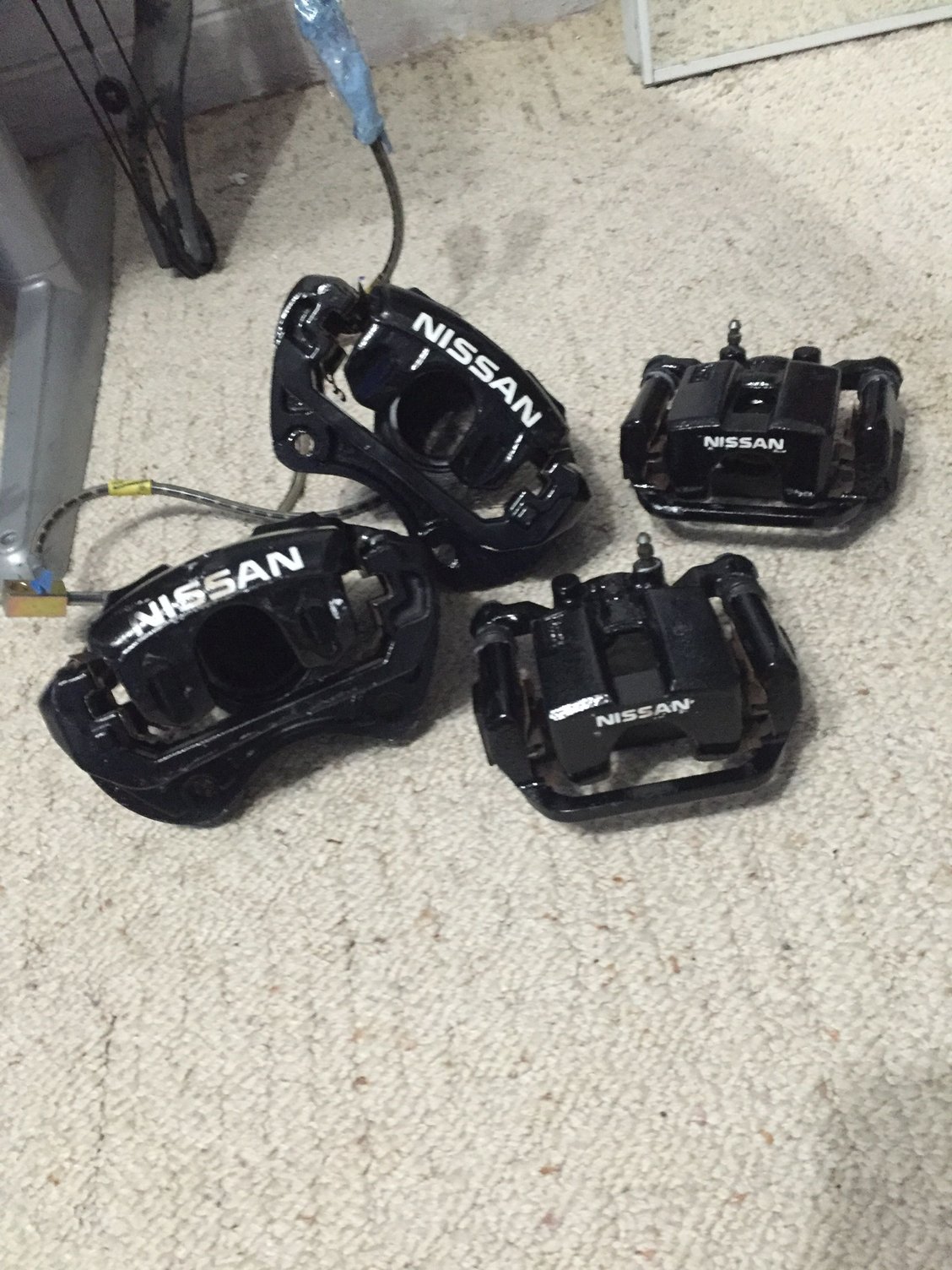

Update: just finished all 4 calipers. Unfortunately, the cold weather outside made the drying process longer than I expected and I messed up a bit. But redoing them seems obsolete. Here they are - 4 black calipers
