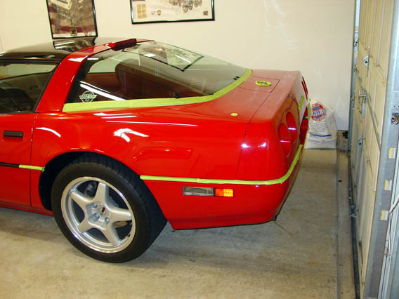

Also, it came up about how to prevent getting wax or polish into emblems, on molding, etc. One way when using a power buffer is to just not get near these. I find that it is difficult not to ever brush up against one, though. So you can also mask these off before buffing. If you plan on doing a polish and wax, or multi-step polishing, then this pays off even more because you mask once, then go to work instead of dancing around emblems all day.
I was doing this today, and it took me about 10 minutes to mask off the back half of my car. Your cars have less molding, so it shouldn't take as long.
Another thing you can see here, is I didn't try to tackle the whole car today. I'm just going over the rear 1/4 and decklid today to reduce some of the waterspotting my car has. I did the hood a few days ago, and will do the doors some other time. You don't have to spend an entire day working on your car, you can spread it out. This is less time consuming at once, and less tiring. And if you have limited pads and towels, you don't have to worry about running out in the middle of a detail since you are doing a smaller area.
This can also be useful if you don't have a garage. You only have to keep one area of the car really clean, and you will be done sooner.
