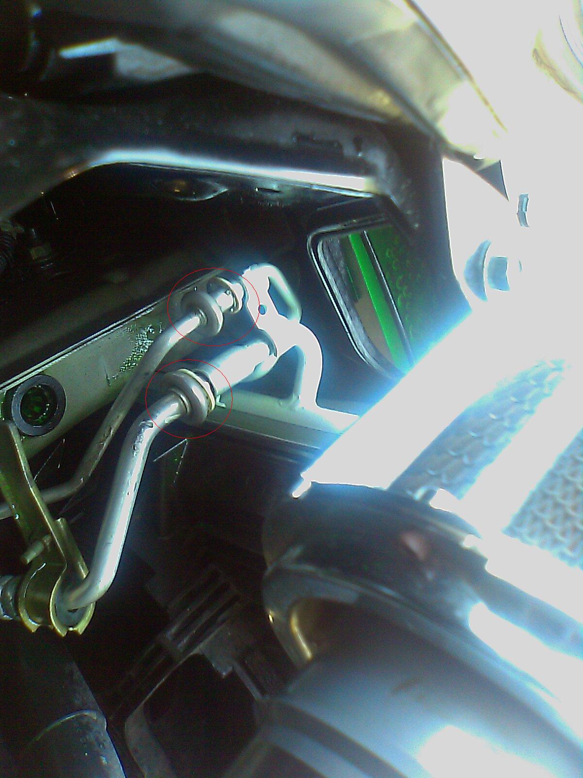

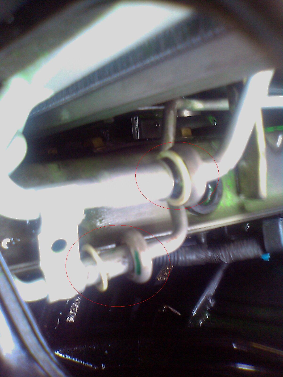

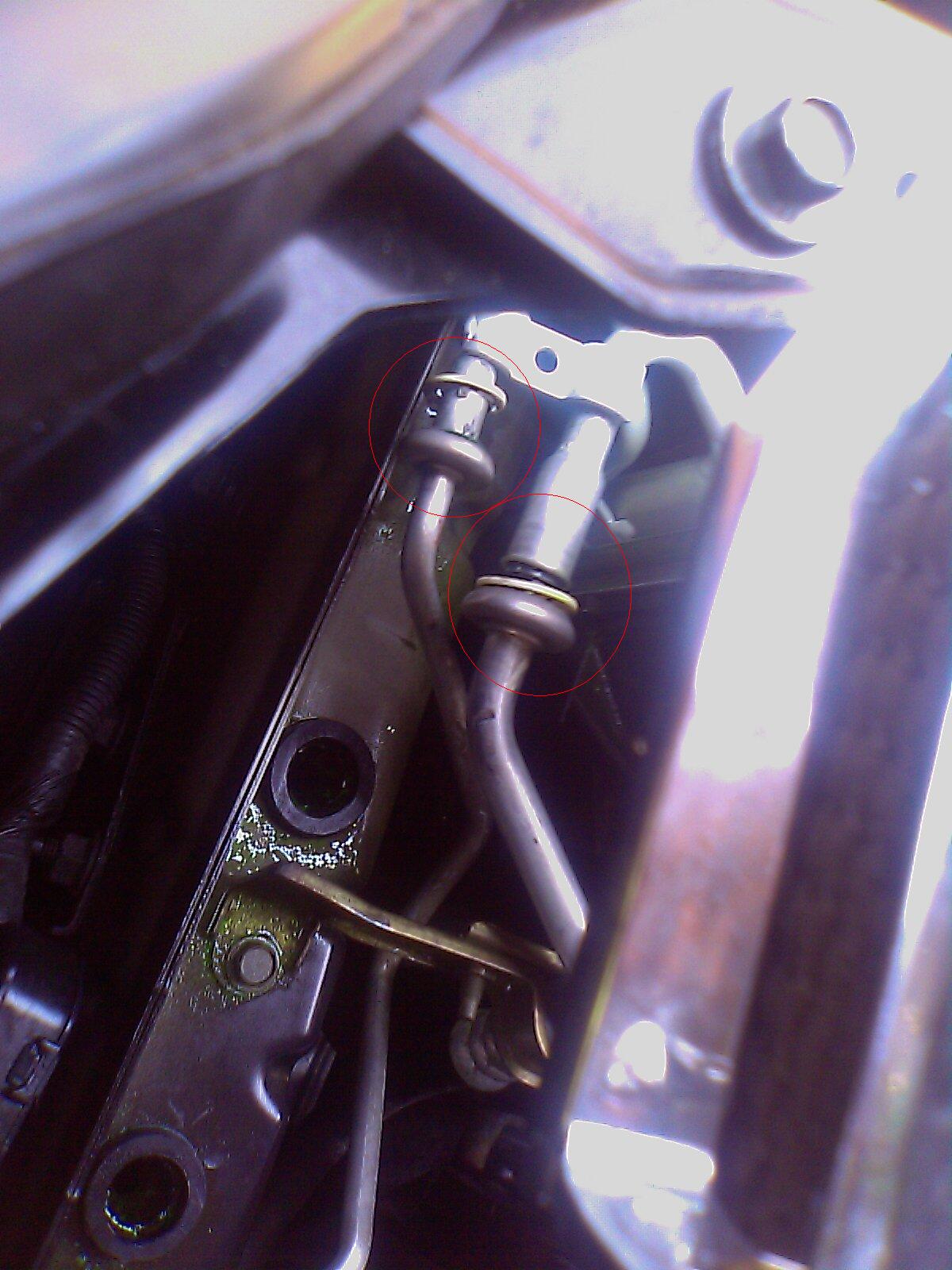

Just a few minutes ago I was going out to get something to eat. I turned on my car and let it warm up for a few second. I drove the car down maybe 4 blocks and heard a loud pop like the sound of a blown tire and seen a plume of white smoke . I pulled over, turned off the car, and opened the hood. It look like the incredible hulk got cut under my hood. There was coolant everywhere. Two metal pipes leading from the radiator ruptured. I retained all the gaskets, put the two tubes back, and limped the car home . I'm guessing the heat caused this to happen and I'm trying to figure out now if I can fix it myself or will i have to take this somewhere to get done. I've taken some pics with my phone to show you what happened. If anyone has any theories or ways I can fix this please chime in. Warning... it can happen to you. I circled in red the busted pipes. I glad I close to home when this happened and now this gives me something to do for the rest of the afternoon .

Those look like the AC lines going to the condensor, not coolant.

Could be there was coolant all in the inside of the engine bay. What do u think caused this?
Edit: Just confirmed though looking at my service manual it's the one-touch joint. Reading up now on how to fix it.

Coolant, or green liquid? It's likely the oil and dye from the refrigerant system, just went everywhere because of the pressure in the lines.
Ever had your AC serviced, lines or condensor replaced?

Yeah I just looked in the manual and its talking about a one touch joint. It was a neon green colored substance. I though it was coolant since when I looked at my coolant level it was tapped out. No i didnt have anything to do with my a/c worked on recently.

Neon green is AC dye, coolant doesn't really appear neon at all. Easy solution for the daring, taste it. A little amount won't hurt you.
Sometimes freak accidents just happen
So you said the o-rings were still there, and the lines snapped back together properly?

No none of the lines just snapped back, I just placed them back the best way I could which u can see in the pics. As I'm reading the service manual I have in from of me it says that this can be fixed by hand. Going to go look at at it in a min and see whats really going on. Does this mean i will have to get my ac serviced on now?

You'll have to see if there's any damage to the connectors, not sure why they'd just pop off like that.
Yep, you'll need to have the system recovered, evac'ed, and recharged.

It's driveable, yea. I still don't believe that's coolant everywhere. Check the level in the radiator, if it's up at the fill neck (and assuming the overflow has some in it) then you're good. I'm betting that green crap everywhere is dye for the refrigerant system.
Don't bother trying to use the AC, the compressor won't kick on if there's no refrigerant charge in the system.
