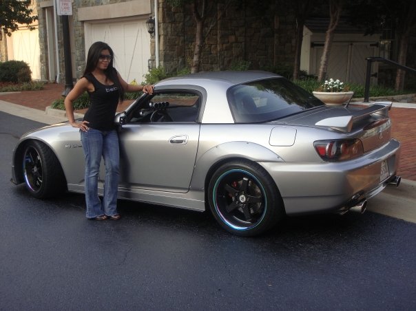

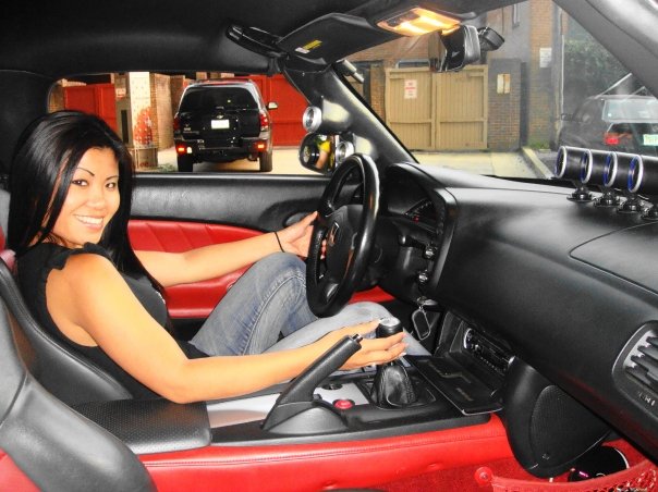

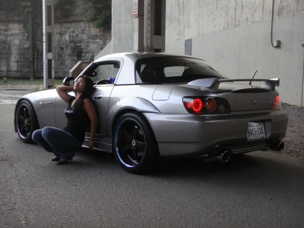

Sorry the pics are small.. not very good with this stuff lol..
But these are the pics of what my car LAST looked like...My car is at PTUNING in manassas and is being rebuilt. A new turbo kit is going into the car and hopefully pushing 450whp on 12psi with a gt35r. this is my 3rd time turboing lol
New enkei PF01 rims.. new side skirts, new ings rear bumper ect..
As you can see my s2000 is my show/toy car and my Z is gonna be the daily cruiser... Although.. i've been thinking of 19's, lowering, and a lip..and exhaust and TP lol... and maybe a nismo wing hahaha...

details on girl in pics?
