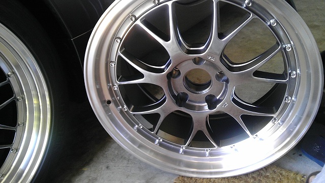

Anyways. Uncle ben's dollar store rice just got in. I love me some fake rims!
Attached Thumbnails 4.08 FD + Carbon 1.5 LSD + Hill's Garage = Awesome-imag0147.jpg

I thought everyone could register at the same time.
What size wheels?
Old Aug 30, 2011 | 08:53 AM
vtchang's Avatar
vtchang
Posts: 549
From: Virginia
19*9.5/10.5
