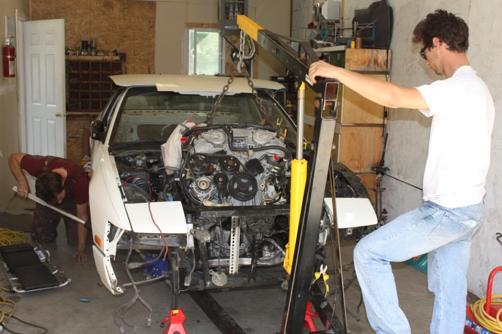

Nope but I did get the motor and trans in yesterday for the test fitting / clearancing .
have to find out how i am goign to solve a few problems . other wise it looks quite at home in there a lil tall tho haha.
will have pics as soon as i get them from my buddy

From: alberta canada
me bolting in the partly cleaned sub frame lol
hood and bumper off ready to drop in
tons of room up front
puttign on the engine balancer now
I think its a lil tall hahah
one of the headers put on see how much room there is this is the3 one i will have trouble with clearing the steering shafts .
Now i am gonna measure every thing up for my new drive shaft. and the trans mount doesn't work so i have to build my own.
Now if my test drive shaft is sitting at an angle i may be makign my own engine mounts to get the motors lower and the drive shaft as level as i can get it . . more to come
Joel
