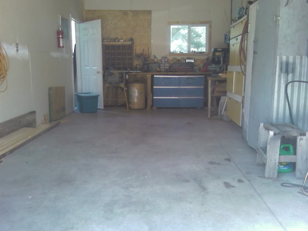

My shop space

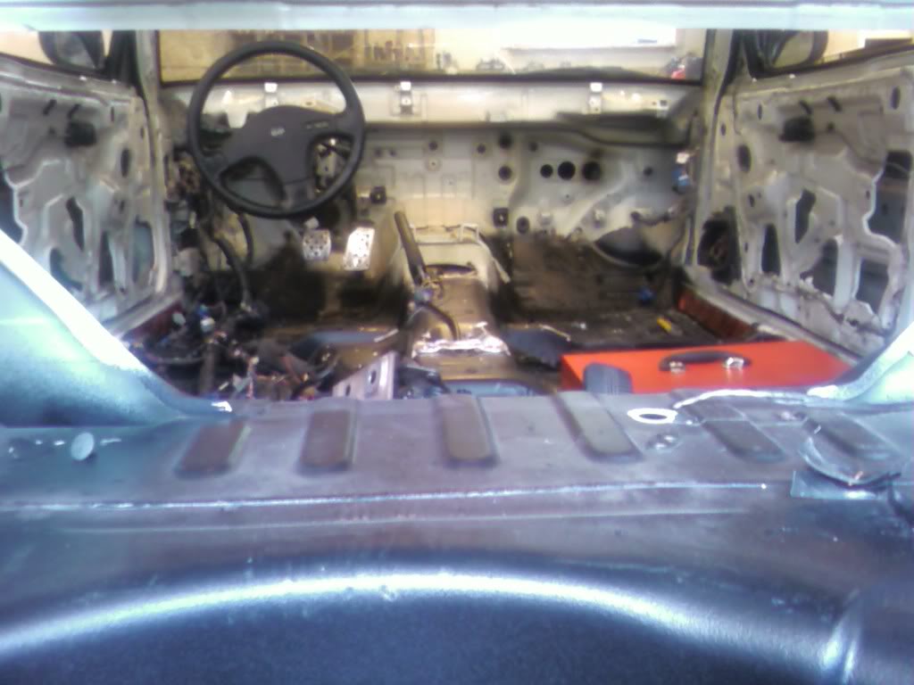

before i started ripping it apart

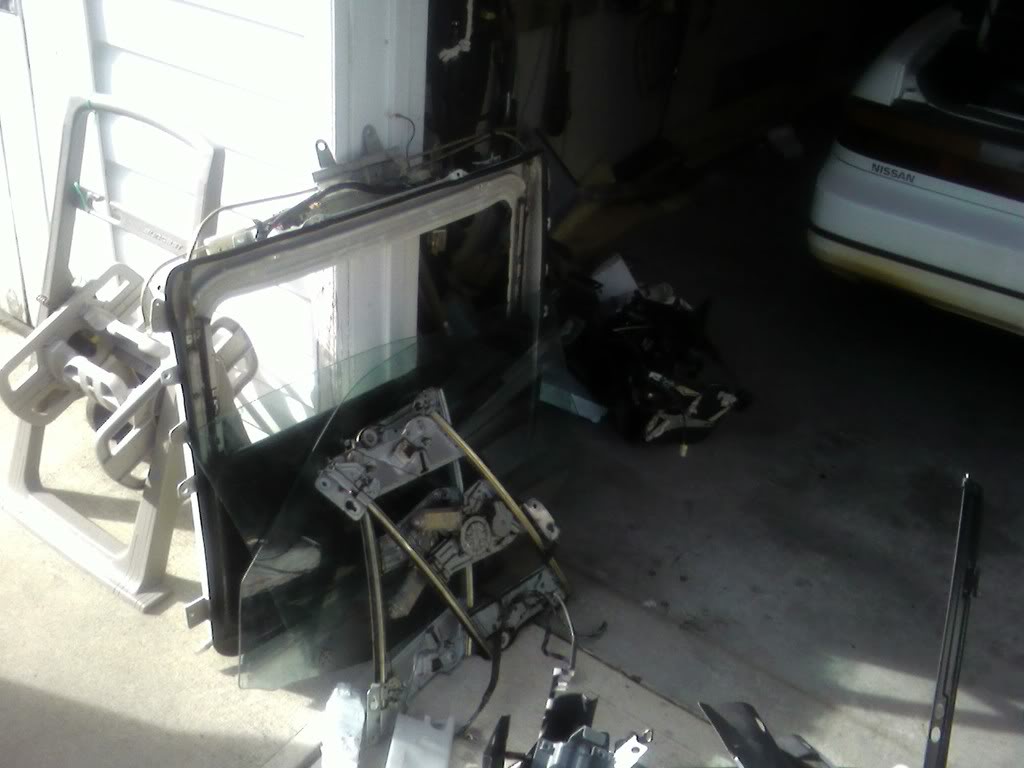

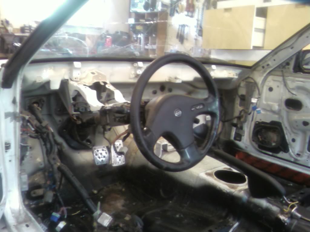

start the stripping !
sun roof gone
thing was held in with screws pain in the *** to take out

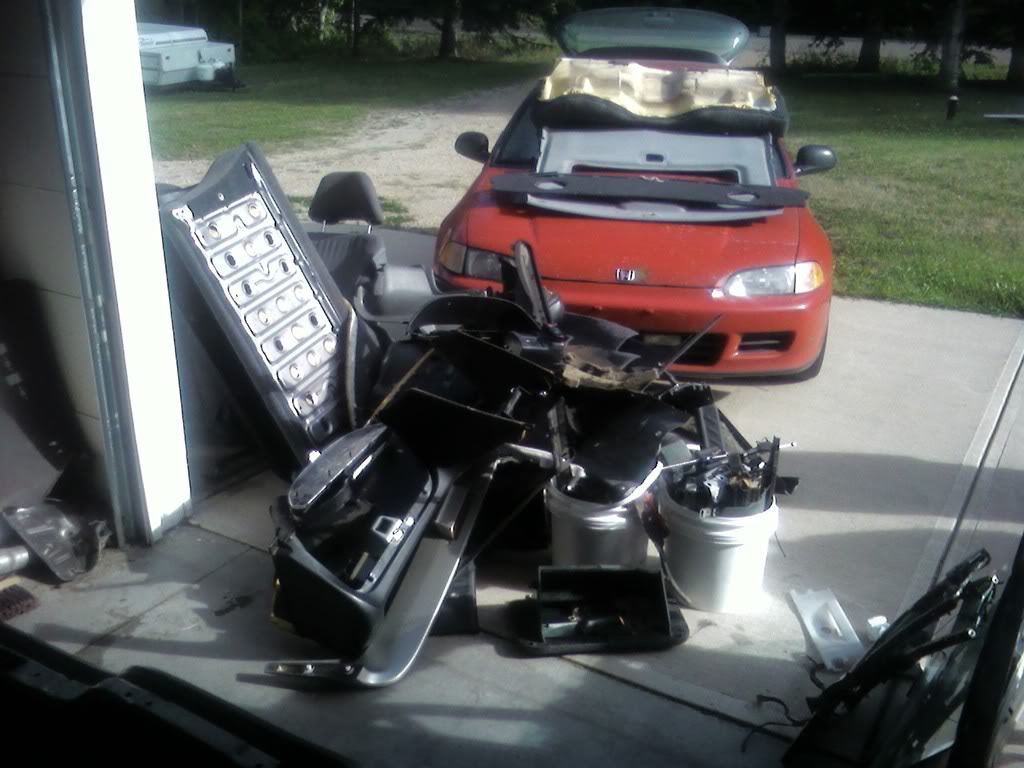

the piles of junk

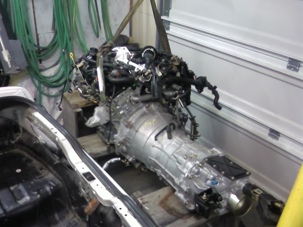

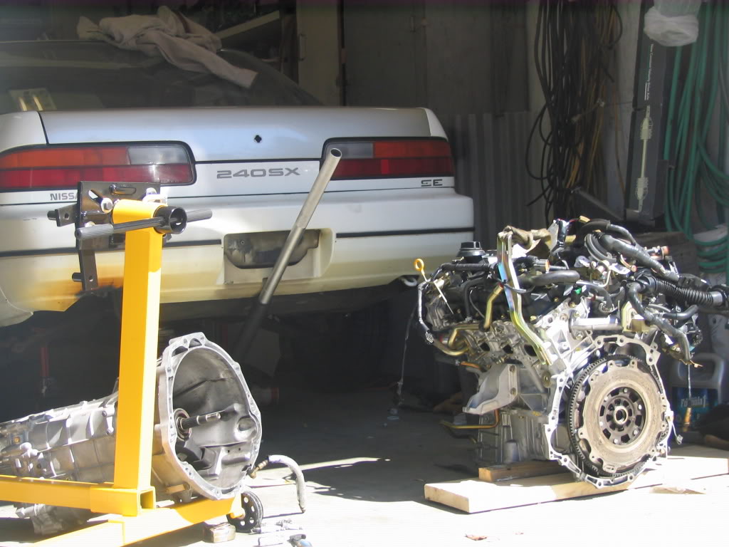

And the VQ35DE sitting around

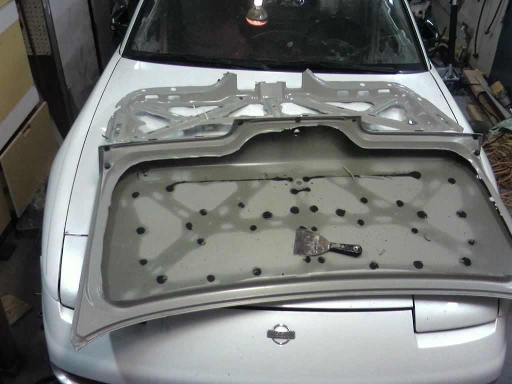

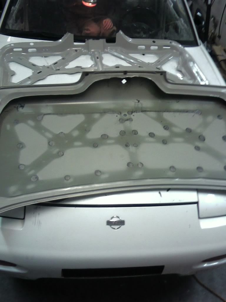

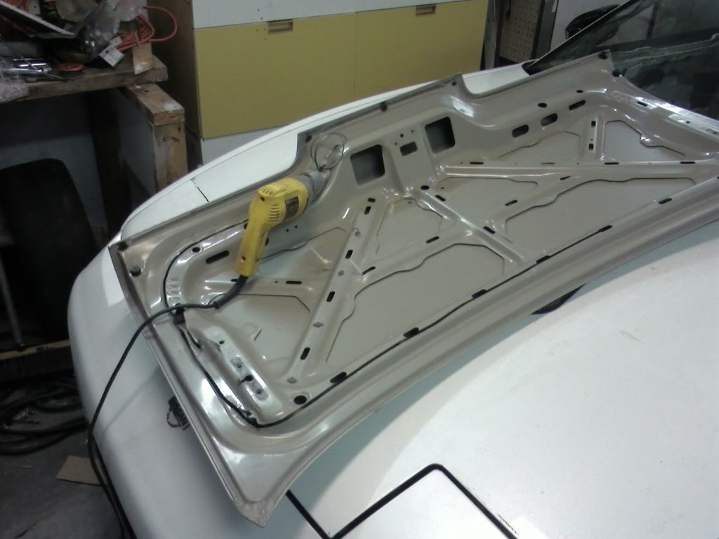

and i was workign on gutting the rear trunk lid.
Sweet dewalt tin shears make quick work of the sheet metal .
after i cut all the way a round it the only thing holding it on then was the black tar ****. I used a small torch and heated up a putty knife to slide under the ribbing and pop the ribbing off. took about 30 mins to do it and this is what i got when it was off.
then used my olfa to scrap more of the tar off. and trimed a bit more. and all done .
took about half the weight out of it. and its still pretty ridged . i might toss a support bar of aluminum across the width of the lid to give it a touch of support .

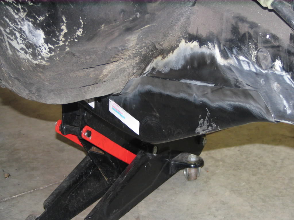

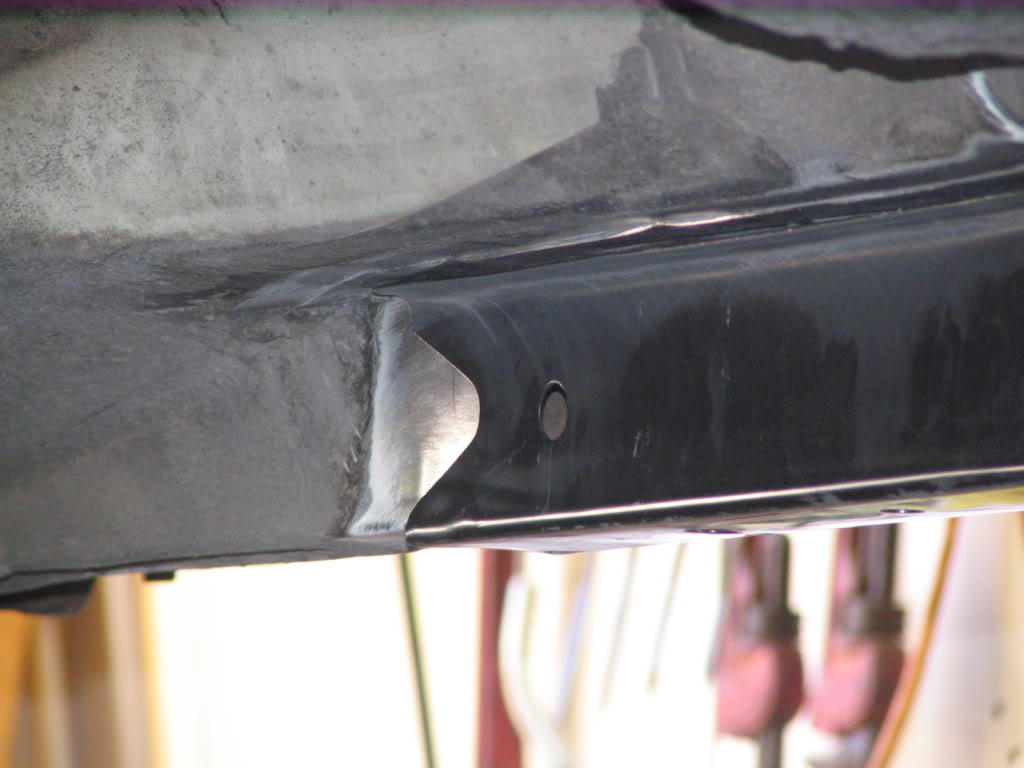

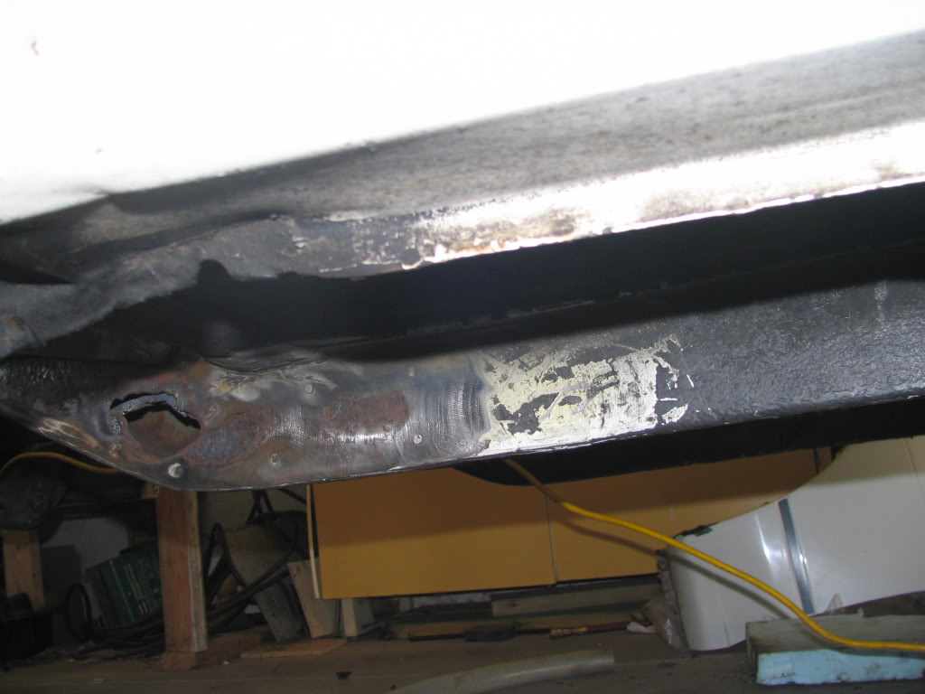

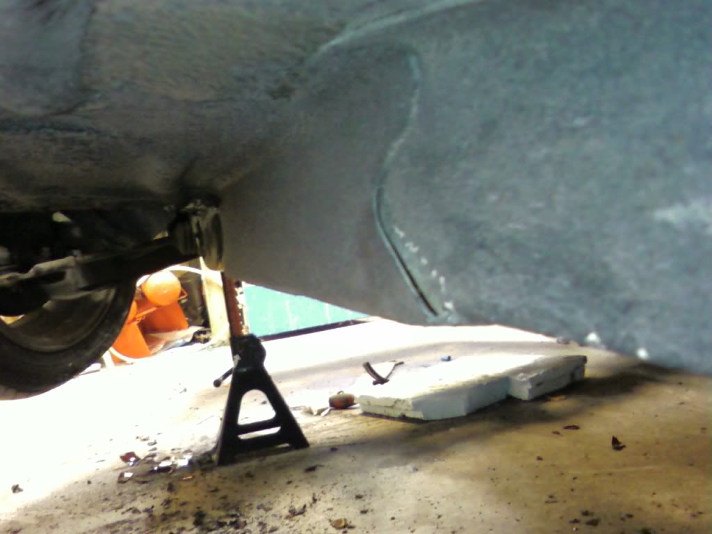

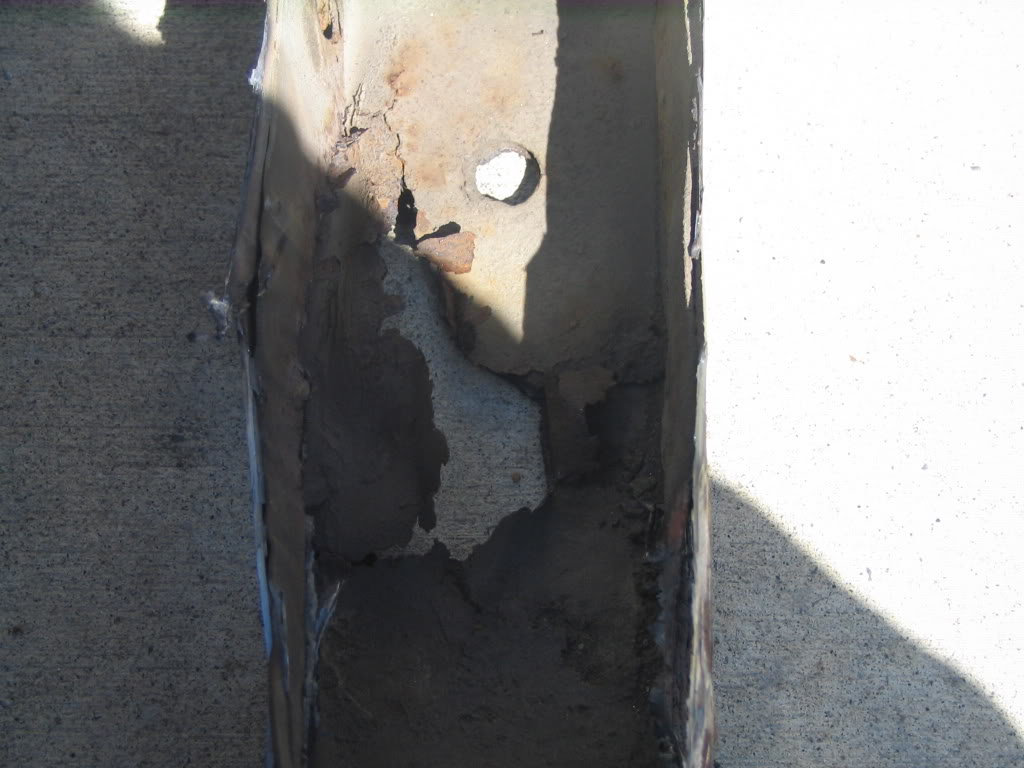

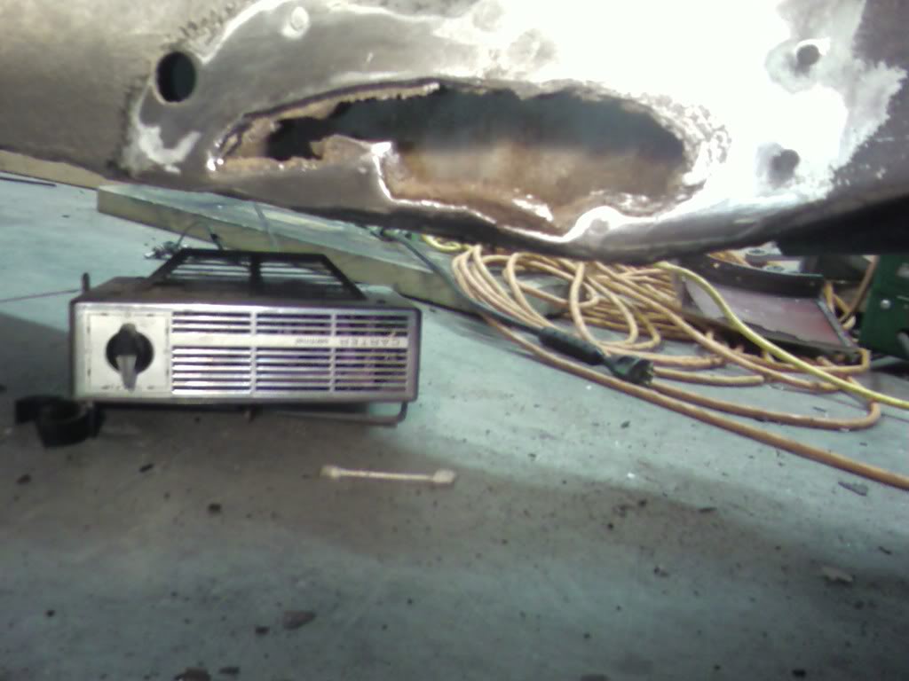

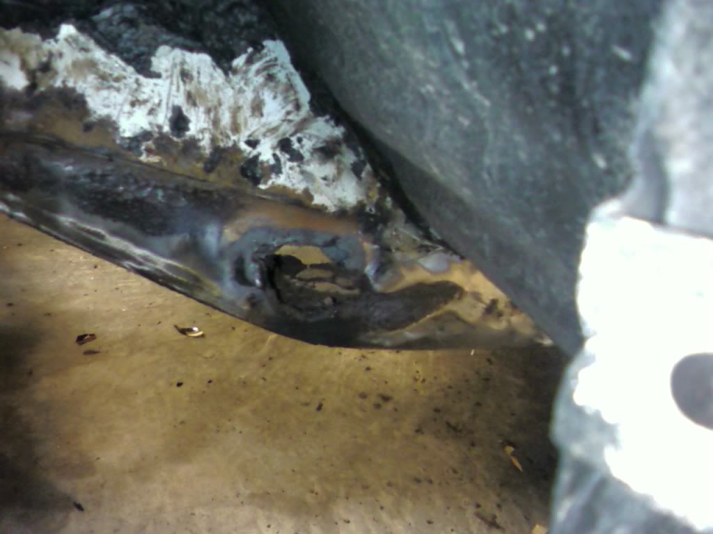

tried to use a lil cuttign torch to cut out the rusted frame rail spot . well it wasn't up to the thickness of the metal soo it didnt' work . I did get soem more worse news the other side of the rail is also rusted so patching is isn't a go any more
this is all i thought i had to deal with

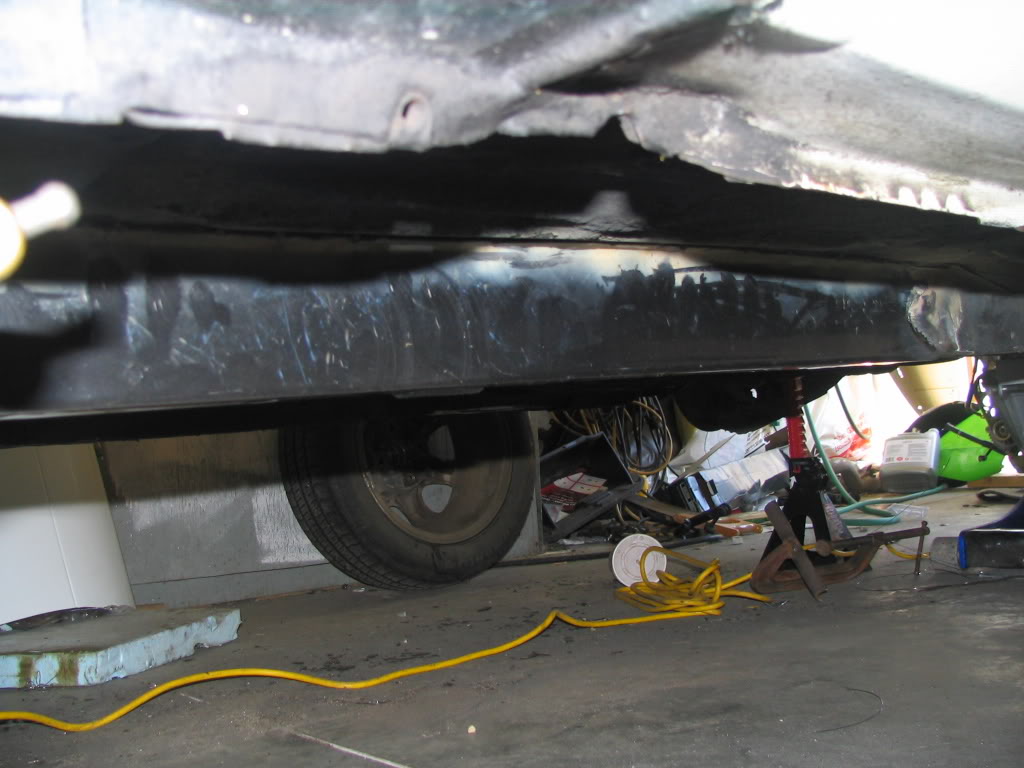

but on the out side of tha rail once i chipped / burned off the under coating/ did some grinding i ended up with this on the other side.

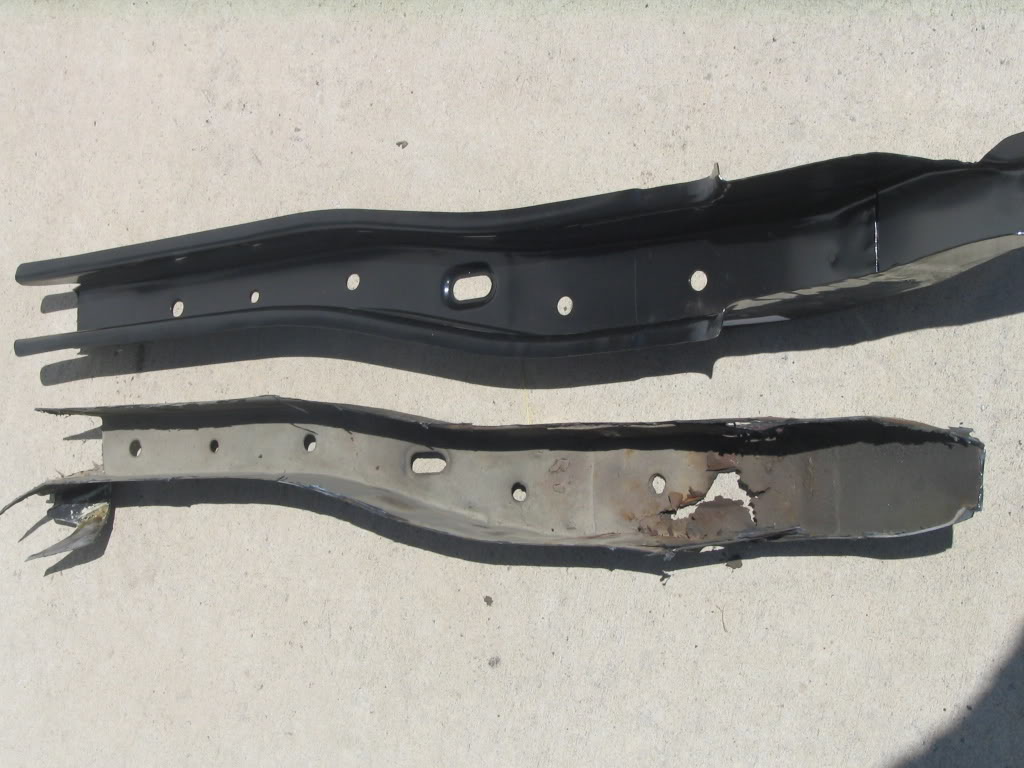

So i am not going to try and patch it any more So went to sherwood park nissan and ordered a new rail section cost me 107 bucks so should be here on wed new shinny rust free rail section .
then tiem to cut and weld

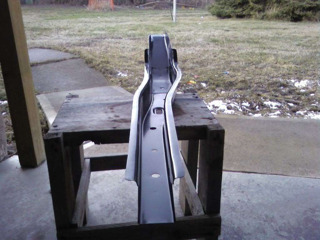

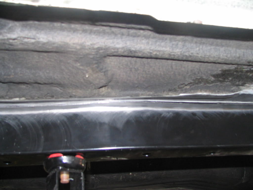

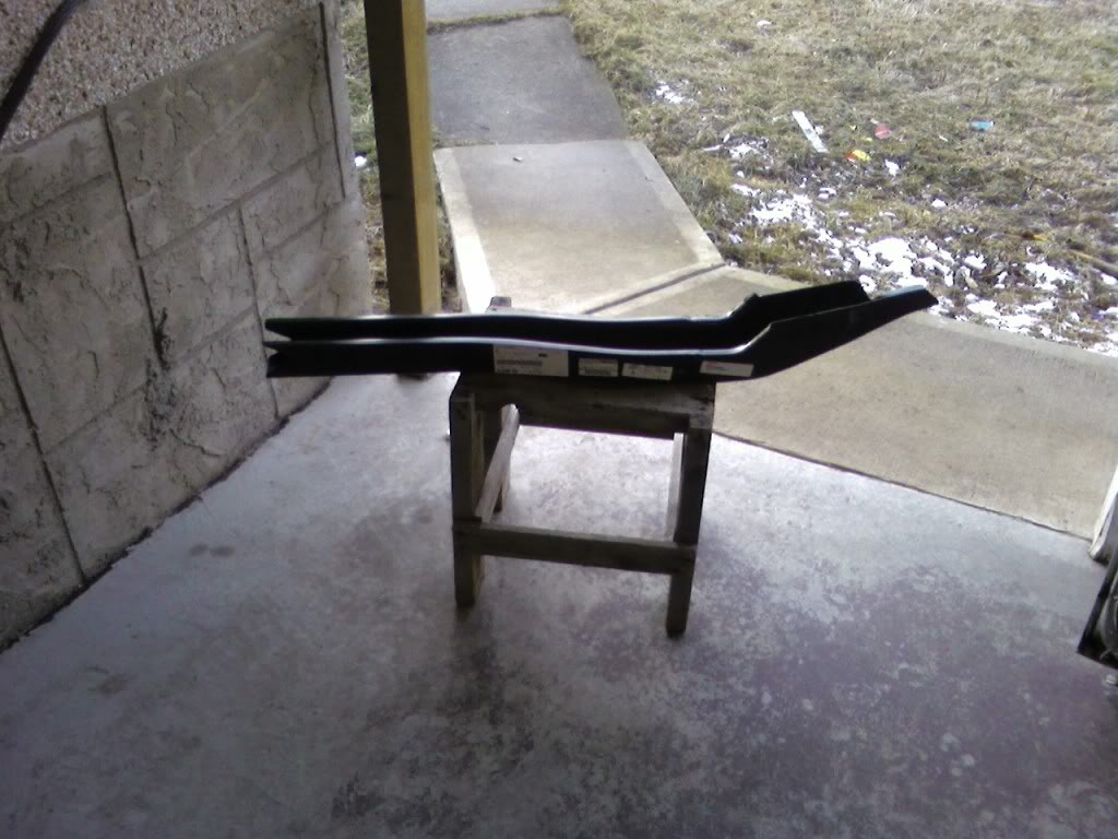

So Frame rail came in on friday so went to pick it up . I was pleasantly surprised at how big the rail section was. it measures up to 43 inches long ! witch is awesome
look at how nice it looks
Here is the is the old one on the car
the seam on the right hand side all the way to the left is being removed

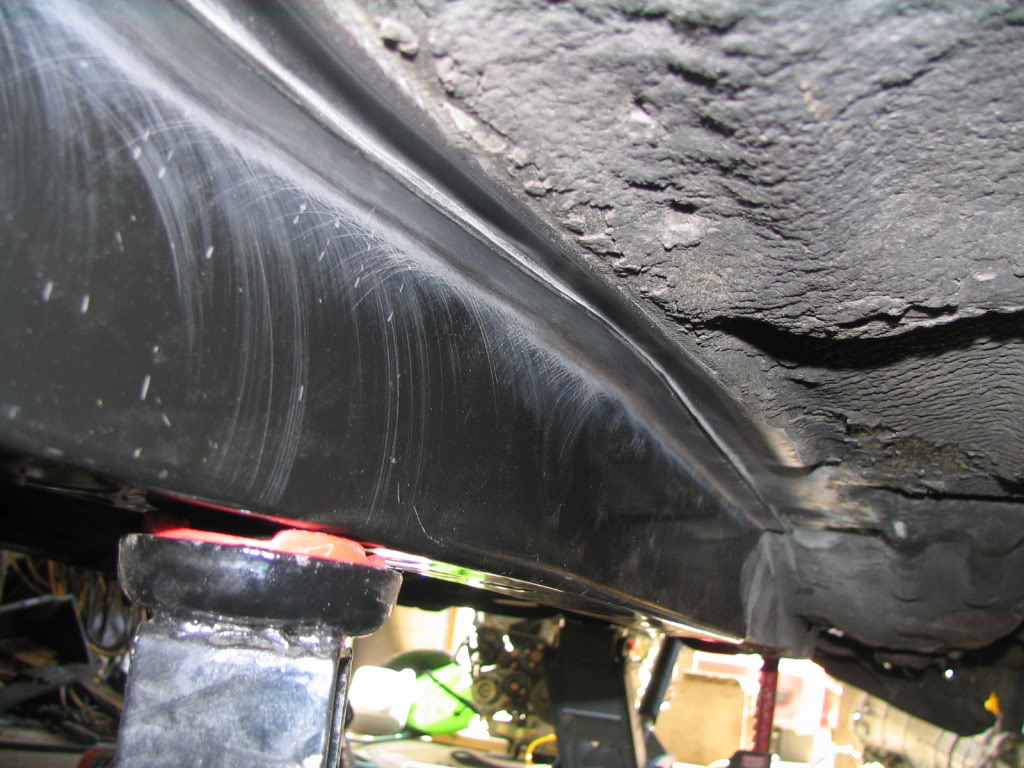

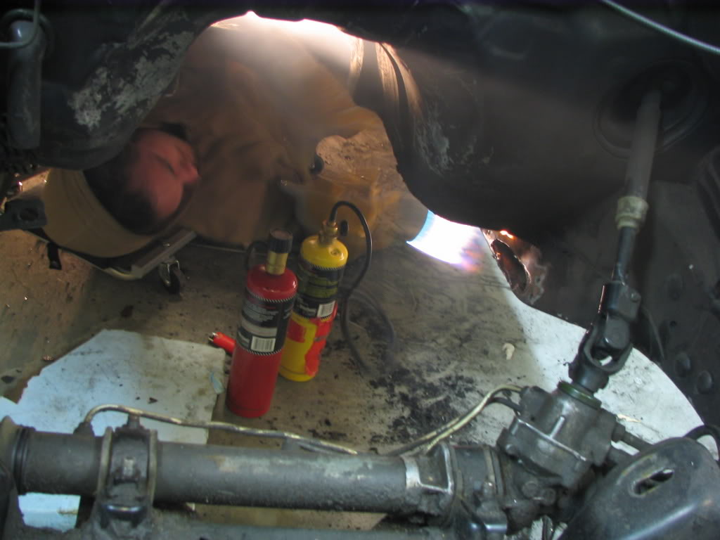

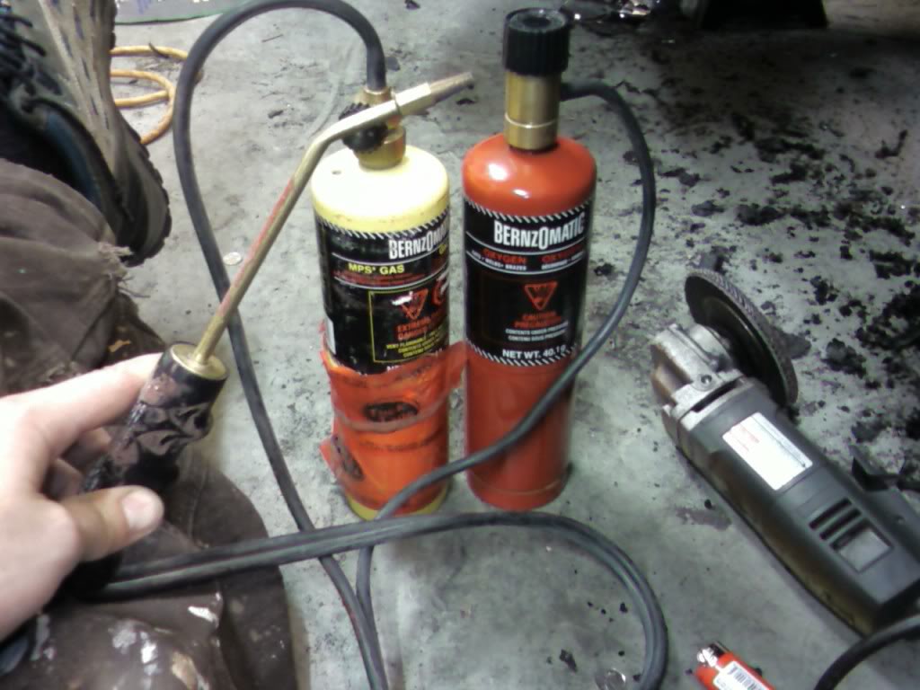

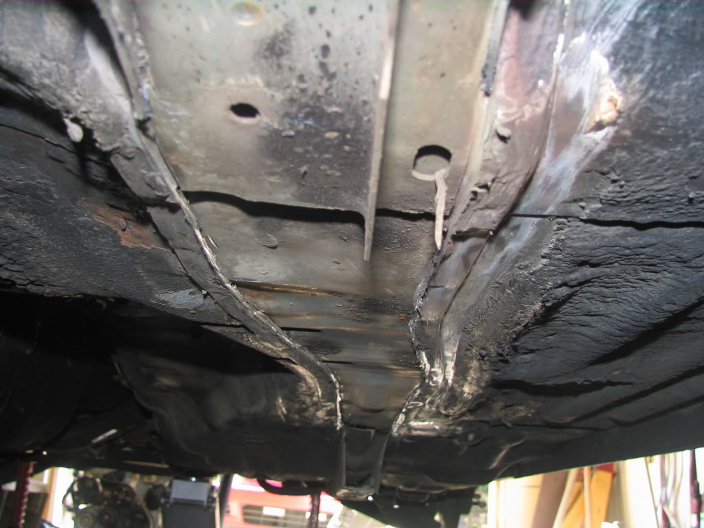

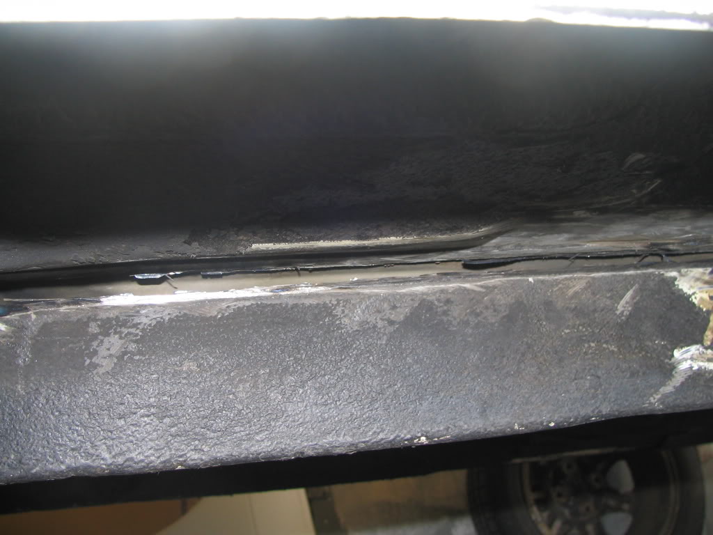

So I have to scrap an area clean for the new rail to be welded

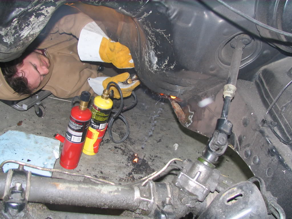

because iam lazy and like fire i decided to heat the under coating up so it just wipe off pretty much .
So i rigged up a maps gas tank and an oxygen tank
then i looked up and i agreed i am a rock star

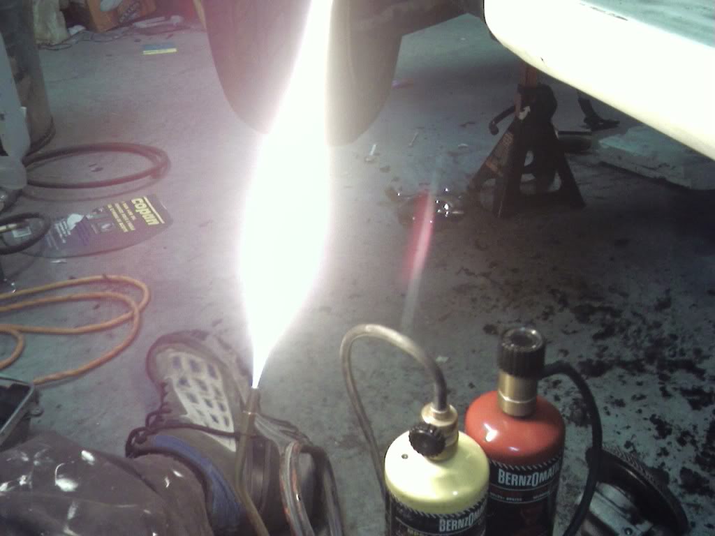

and then there was fire !
so it went well was a tad smokey when i stood up lol

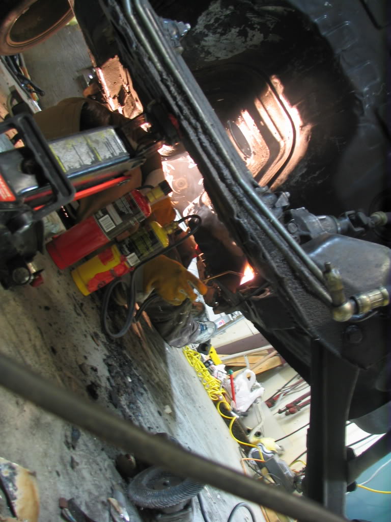

but after i scrapped most of it off i let it harden up a bit so it woudl be britel so i coudl take my nylon brush wheel for my drill and buffed it pretty clean . so have to do the other side of the rail tomorrow night
so more work done the frame rail is ready to be cut off now and the new one put on .
pics .
more buring and scrapping of under coat with my sweet lil super torch set up lol
so now that i can see the factory seam should be no prob at all to gind it off .
then will have to clean more with a wire brush attachment on my drill to make sure its really clean for welding .

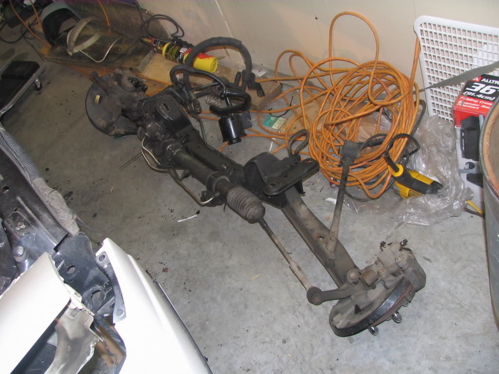

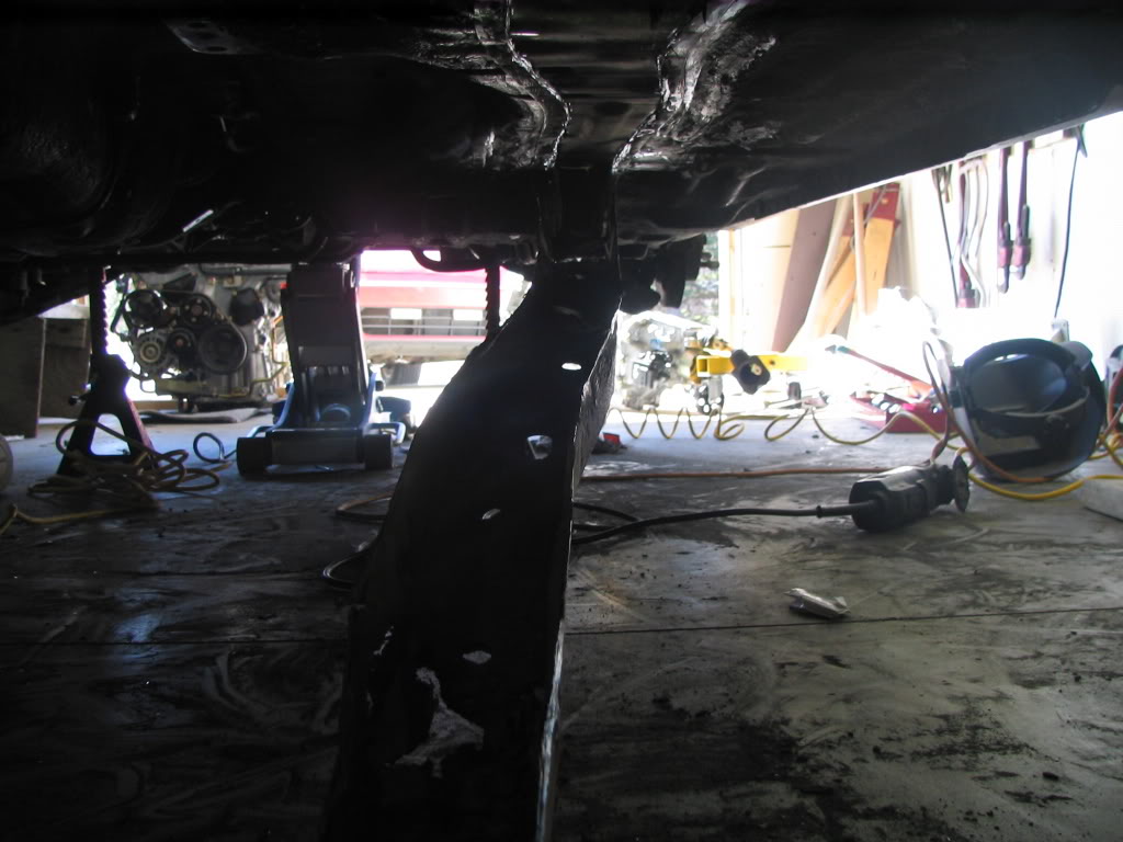

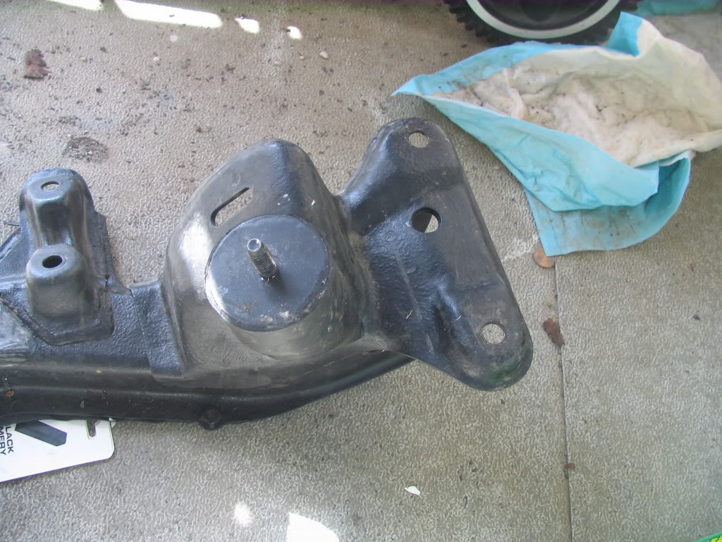

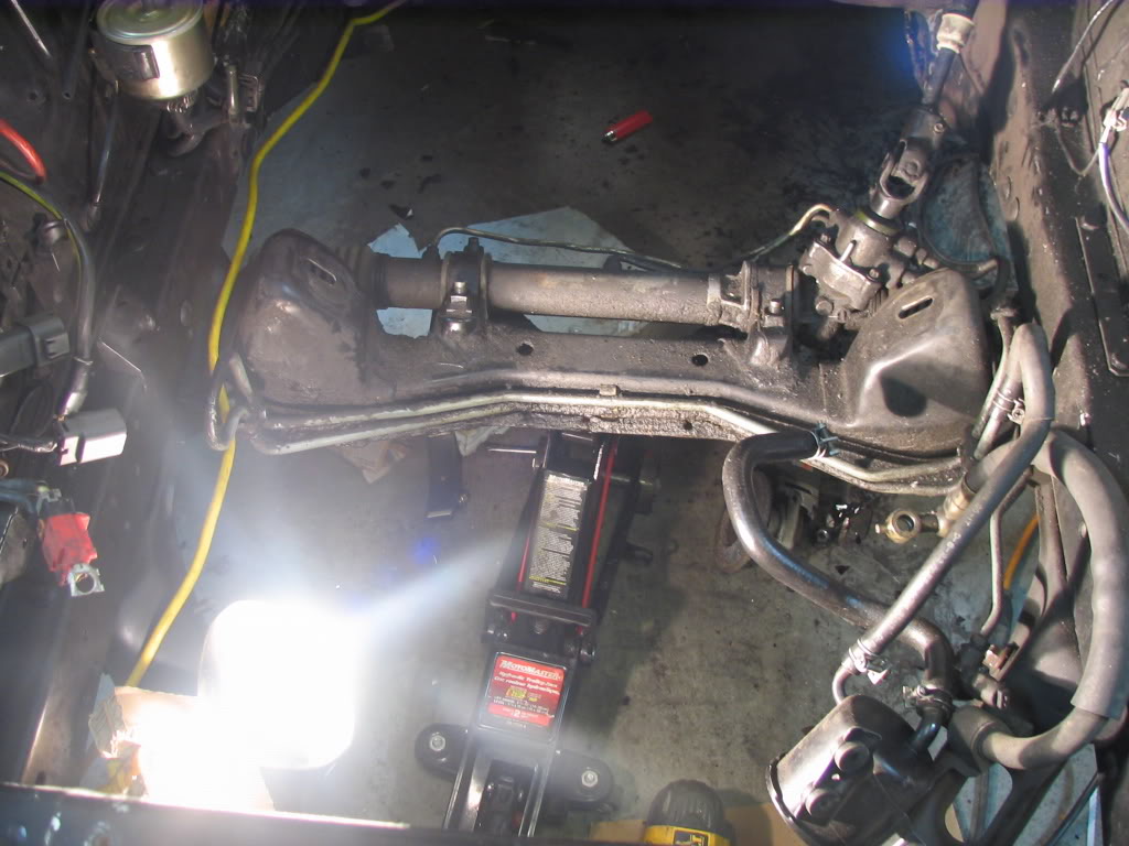

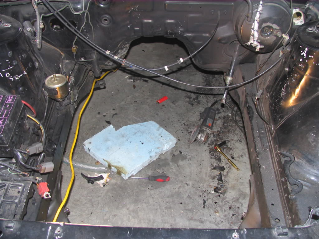

While i was doing that mike was workign away removing the fornt suspension
and the entire front sub frame with every thign still attached
look at all that room to work with now !
So on sat i am goign to start the rail replacement and cleaning up parts of the sub frame
should be a good time
going to cut the rail and weld in the new on tomorrow morn will have pics tomorrow evening

I love seeing these projects. Thanks for sharing.
Those tanks are a little close to where you're working though.
Old May 1, 2009 | 09:47 PM
bigmack000's Avatar
bigmack000
Joined: Sep 2004
Posts: 27
From: alberta canada
haha they were about a foot and half away from me the hose is only two and a half feet long lol

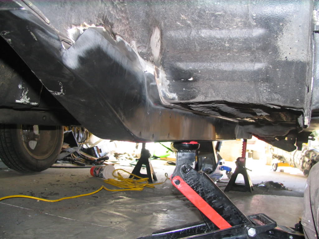

Alright so today was frame rail transplant day over all went fairly well had some trouble with the welder tho but that's ok will fix it up in the next couple days.
heres the pics no action shots due to lack of helpers lol
so the start old frame rail with the lip exsposed so i know where to cut
rail cut and started prying away from floor
one good kick and presto
all that is holding it up is one spot weld that i busted with a chisel
rail detached
side by side old rail and new

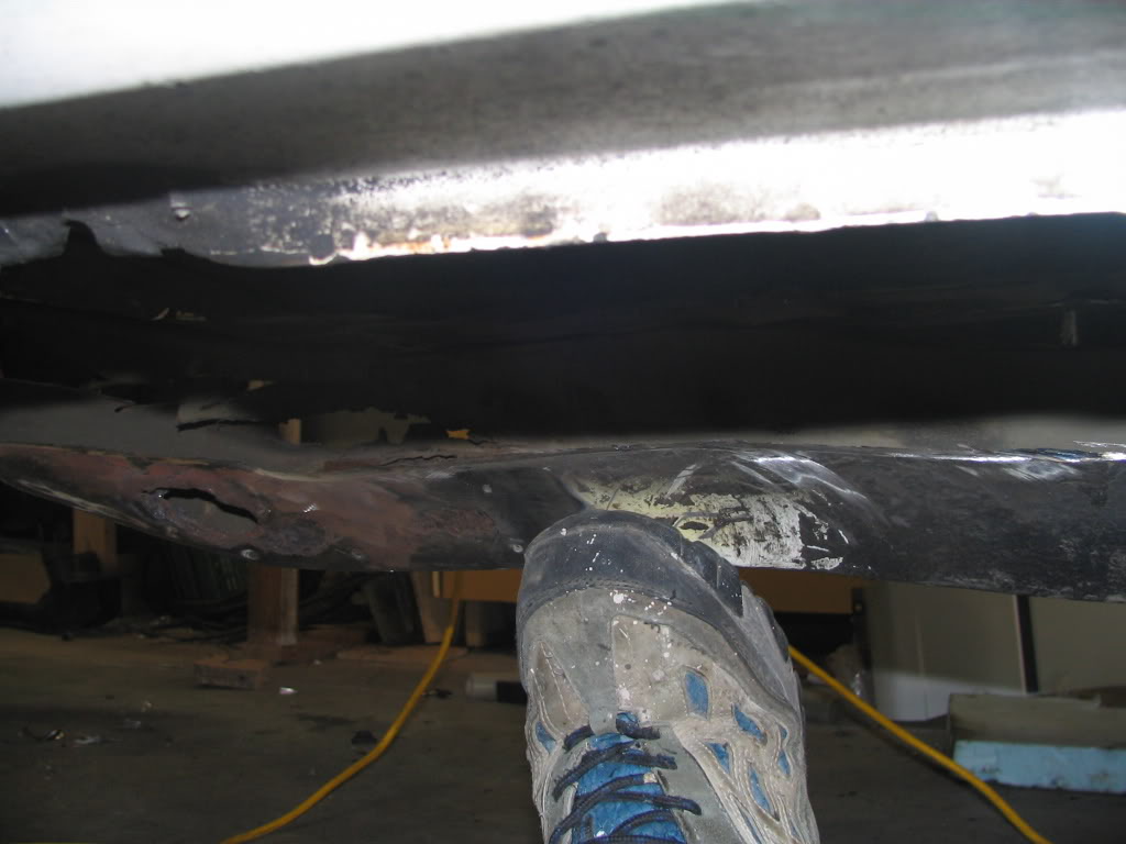

the damage
sweet pick i took while eatting my lunch
cleaned up the floor so i had a nice contact area for welding
New rail held up into its new home !
had a slight gap that i had to pound down with a hammer to get a nice tight fit
20 mins later after beating the **** out of it
from inside the engine bay this is the part that gets all the heat form the factory down pipe that is the cause of the rust
rear section fitment
and then tacked on on both sides
have to find out why i was having trouble with the welder i think it was the ground but i moved it and even cleaned new areas for it but still no help .
hope to have my crap welds gridded down and then have some nice ones put over top next week .
Joel

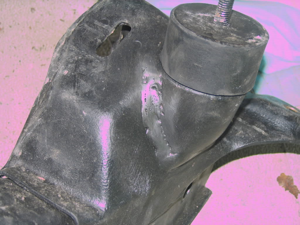

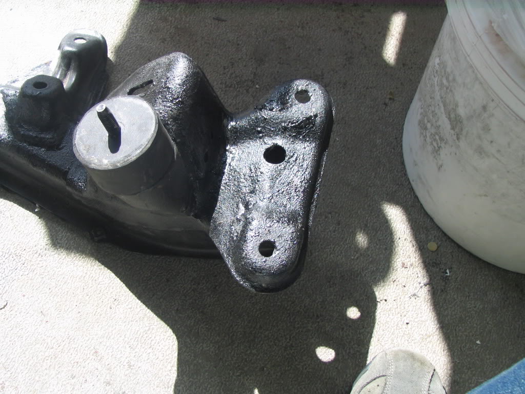

well test fitted the sub frame and it fits like a glove.
but the new engine mount points on the sub frame were caked in under coating spray
and i wanted to see the quality of the welds under the coating so i took a wire wheel to it and holy hell this stuff was strong it took an hour to expose the weld surface.
and just as i thought they were ****
not sure why the sun is pink in the pic haha but what ever you can see how crappy the weld is
So i decided i want to strip the entire sub frame and re coat it in some thing better.
as takign a wire wheel to it was damn near impossible and i wasn't paying 300+ bucks to get it acid dipped.
i met up with my paint sales rep and he gave me this stuff to try
now it says it does epoxy and even baked on coating AKA powder coating ( BS right ) . but it was free so gave it a shot
so this is where i tried

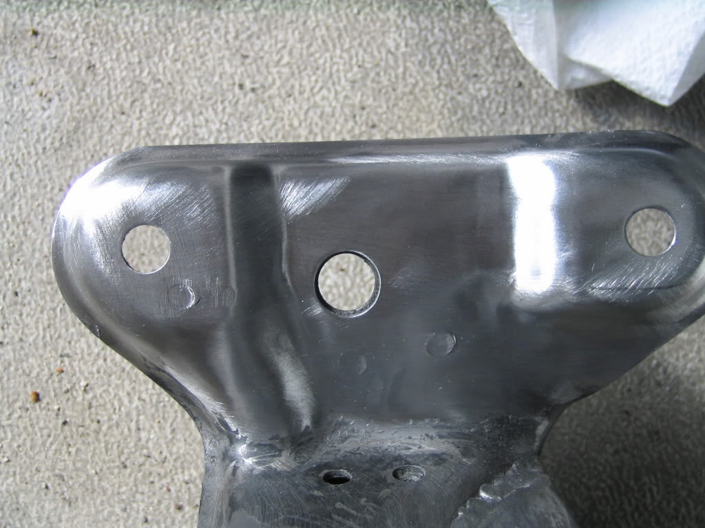

so pasted it on let it sit for a bit
took a putty nice to it after 8mins ! and holy **** ! it worked !
so i caked more stuff on and let it sit for about 15mins and then went scrapping.
after i got the majority off i scrubed it with some simple green and then just rinsed it off with water after and then took a wire brush to it for a few mins and this is what i ended up with
all in all worked awesome
but got lots more to do hahaha
oh well
Joel
