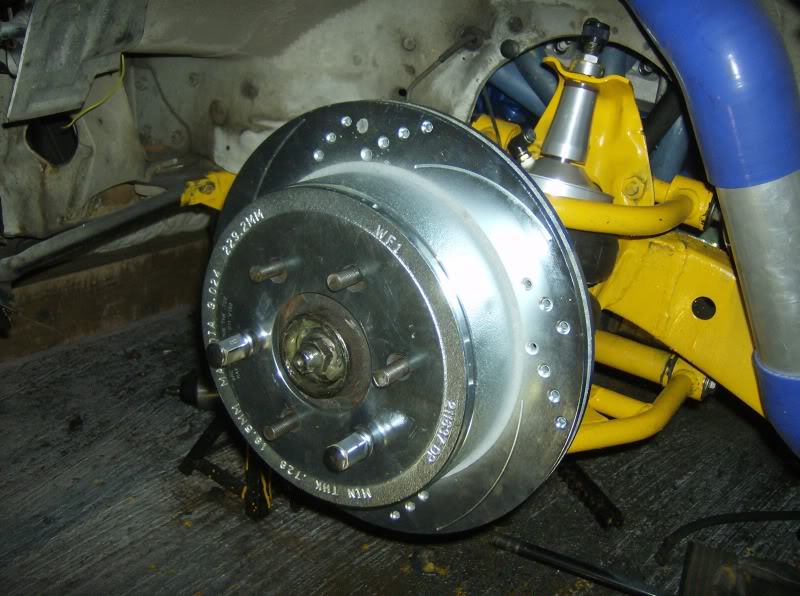

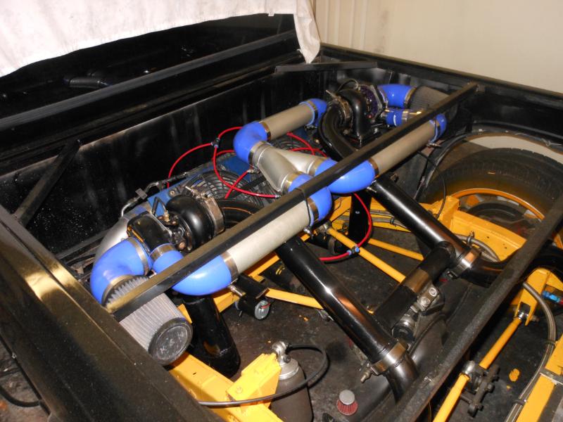

Thanks Jennifer. I've been building engines for over 35 years now [wow, time flies], and its always good to know what your working on.
This engine is new to me, and actually the car I'm working on is an Altima SE-R.
However, there isn't much wrenching going on with this engine at the Altima forums so I came here for a little insight.
Here is one of my creations.

Wow M-train that’s a box chock full of turbos. Also, lots of fine fabrication back there, I even see a watts link.

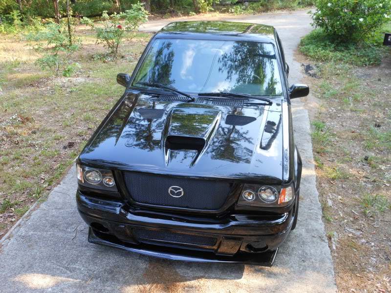

Yep, almost NOTHING performance is made for the Mazda B series truck [and there should be as at 85hp its a real turd].
I had to make all of the suspension, front, and rear, all of the turbo stuff, rack/pinion steering, and probably the only B series truck with 14" front brakes..............lol.
I'm getting into my late 40's, and have learned a few tricks along the way, the Mazda B was a snowball I sometimes wish I never started rolling...lol. Oh, and that is an 03 Ford Ranger front body setup with an 86 Mustang SVO hood scoop.
