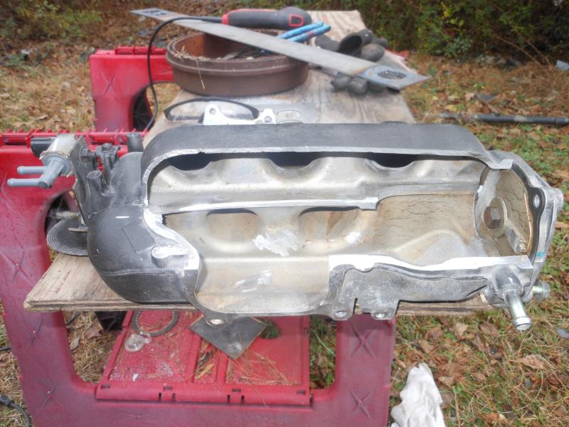

Before:

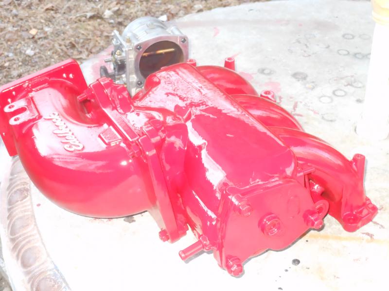

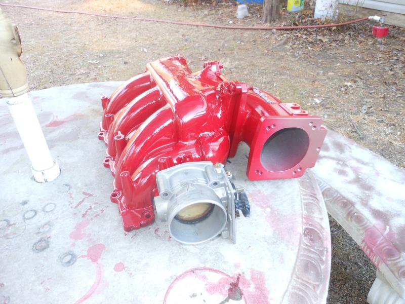

after:

Ok, that makes a bit more sense now. That is the Maxima/Altima manifold right? It would seem that your manifold is easier to modify than ours.
Correct. I will also add that since I don't own a Tig welder I used "Muggy Weld", which is basically a metal rod, and some type of flux.
So, if you don't have a $$$$ tig, and need to weld cast aluminum then check it out.
