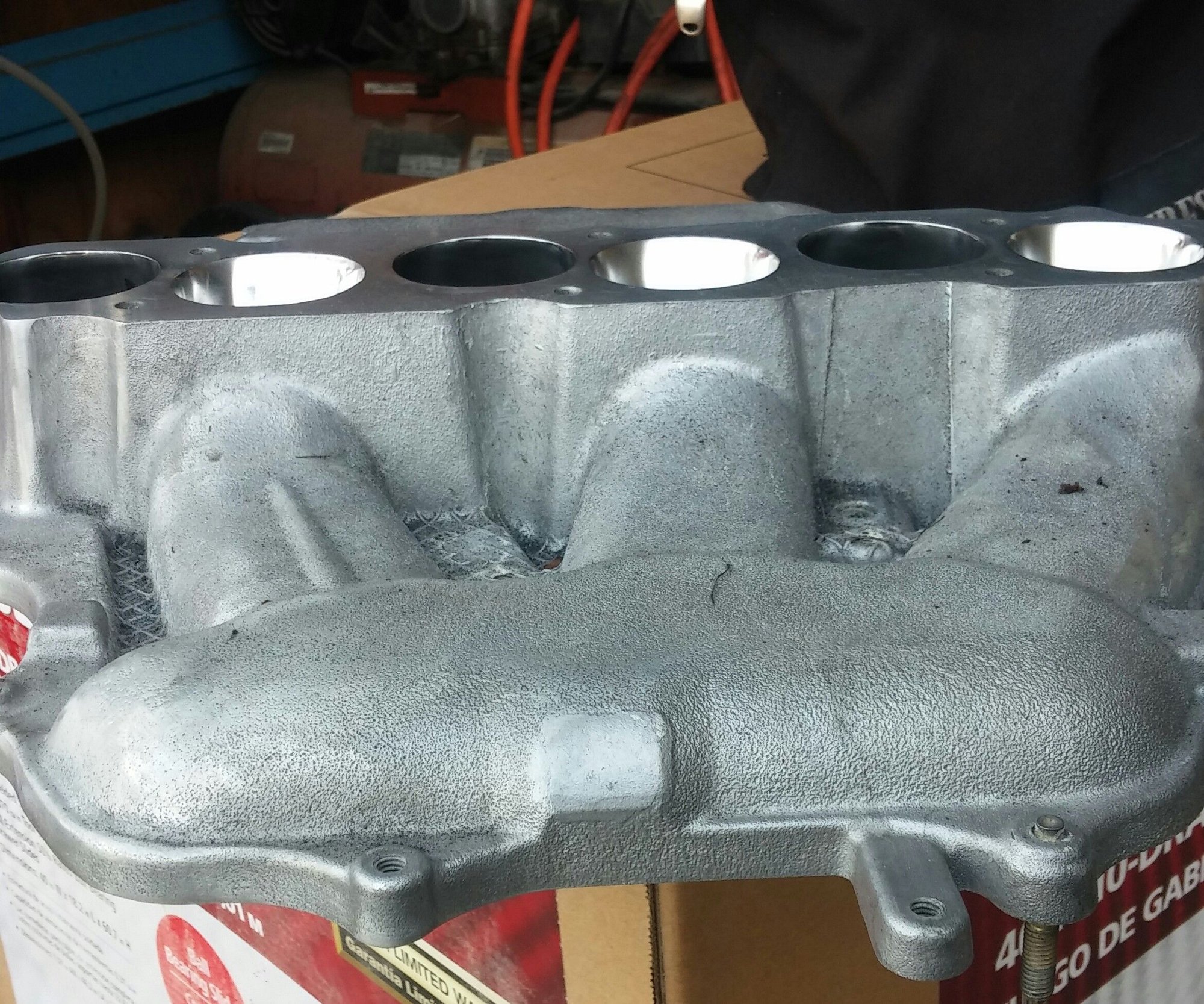

Old Jul 29, 2016 | 12:10 AM
slicnicz33's Avatar
slicnicz33
Joined: Mar 2015
Posts: 30
From: LA, california
Some photos that I found
