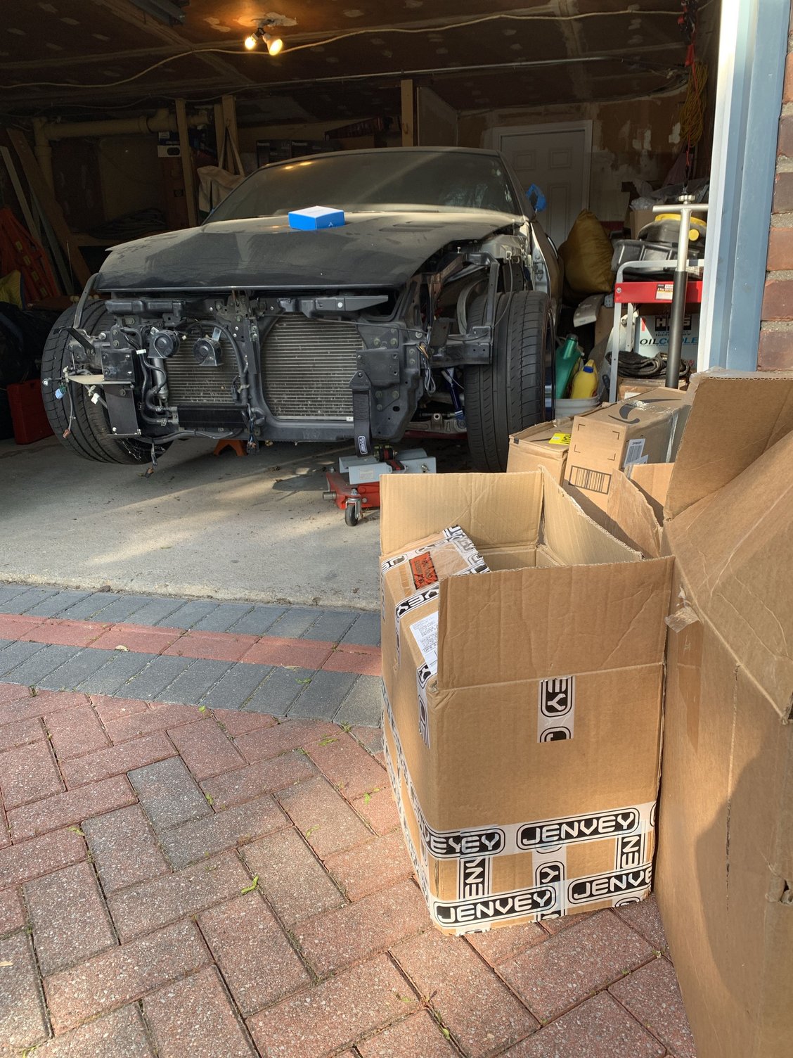

...The Jenvey kit is about $5k....
About half that even when you factor in duties and shipping to the states.
