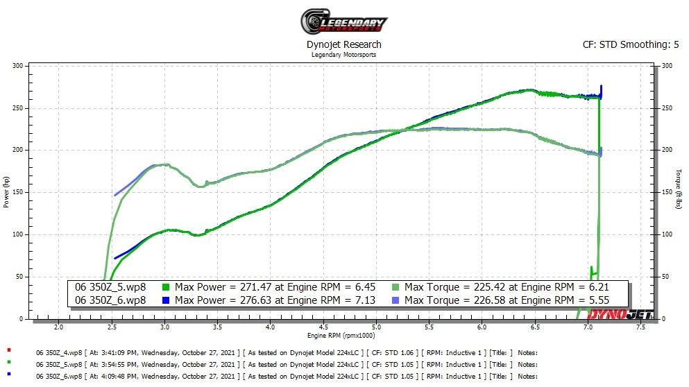

Most realistic option for me is to keep my Kinetix v+ And swap the ported manifold for a oem one and swap the ported lower plenum for a stock revup plenum
heres my dyno sheet:

Wow, I can see why you say it's smooth.
FWIW, it's a nice powerband, so you have a revup already...is the P&P manifold a DE or Revup unit?
I'd definitely want to see what your AFR is, judging off the dyno alone I'd leave the intake alone if I'm completely honest! Highly suggest LTH, that with a retune should pretty much flatten that 3-4.5k dip and make the car feel so much better.

How does your cam timing map look? I would be looking into mechanical or tune related issues rather than your choice of parts.

Dnash brings up a good point - be 100% sure your engine is running healthy.
Cam timing and Variable Cam Timing would be good to check in a datalog
Back when I had the greddy twins my VVT was being spotty during a dyno tune. Without VVT I was down 80ft-lbs of torque, I never realized how important variable cam timing was!

I attached a PDF of my data logs from that dyno pull. Not sure if I attached it right but hopefully y’all can view it. Lmk if you can view it

The PDF works fine but I don’t see any cam data. Are you able to access your UpRev?

I’m at work now, but tonight I’ll hook up the laptop and record a wot data log and I’ll add any/all of the cam option parameters to be recorded on the data log, and I’ll post it tonight or tomorrow morning. 👍

Your AFR needs a bit of work, target should be 12.5:1 and should pretty much stabilize at that point throughout the pull. Ok I'm baffled, I thought that was only the case for the 05, so all autos are DEs?
