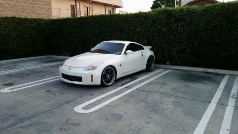

Hello and thanks for reading. Im a new owner of a 2008 350z. I purchased it salvage title (did research on vehicle found all kinds of info on the bin and it was rear end damage ) for 10,000. Handles lile a dream and ive gotten her to 150mph in the low end of 4th gear. It was allrwady lowered. So far ive put a LS Diff and southbend stage 3 daily clutch and light weight flywheel. Ive got about 10,000 I want to put into this car I currently have no real plan or direction. Im looking for advice and mayby some "this is what I would do" 's. Ill be researching the forums and would also appreciate some advice or quick links to threads that funished there build within the 10,000 budget. I just finished a 700 hp build on my 4x4 f350 diesel at truck source . Ill be concentrating on this vq35hr build for now on.

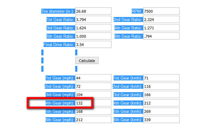

Indeed.
Assumptions used: stock gear ratios (trans.), stock final drive (rear), stock height rear tire 26.68 (18" tire).
Gear limitations are a bish.
Oh, horsepower is not the issue here. Only requires ~160WHP at the contact patches to achieve 150mph.
ASSUMING 0.00 cD.
Ummmm....

Well gee, nice to meet you as-well. It's good to know the moderators will be so helpfull. Well, (for full disclosure) I may have been at the top of 4th or the bottom of 5th im not quite sure. All I really remember is looking down after hauling *** through some gears, saw my speedometer creeping ever so close to "150" thinking and blurting out "oh ****" and begain slowing down. I liked that feeling, and want more. Thats where you guys come in.

Yeah first you shouldn't be driving that fast
2nd you were at the top of 5th most likely. So you trying to show off here.....failed in your face

Oh, and by the way, my first post which you took all wrong was a helpful bit of information.
Gear limitations, aero drag and all of the associated things that keep a car from reaching a higher terminal velocity can ALL be planned out in advance, the smart way to obtain your final goal, whatever that is.
There are planning tools (like the gear chart I showed) that can help to predict just what a car's baseline performance is and allow you to set realistic goals about the ultimate performance; instead of just saying, "I want 450bhp."

Lastly I'd do suspension and get smaller wheels

I dont know about what these other jokers are talking about but the first thing I would do is throw them big baller 20s on craigslist and get some new wheels...

Lol, the 20s came attached. I hadn't considered changing them. I was thinking some white rims but exterior mods wasnt even on my mind right now. Personally I do like the off set look.

And yes, ditch the 20's.
