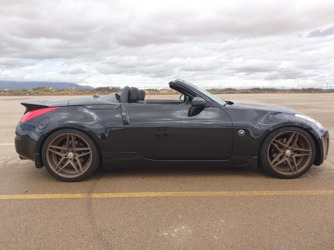

So I finally got some more done on the Z. The fender liner screws had already been removed. I could see where it was rubbing just a little on the fender liner itself. I raised the front by two turns on the coilovers. The back had been a hair high so I think it is now right about level. The adjustments I made to the height are pretty minor. Here's a couple pics I just made:
