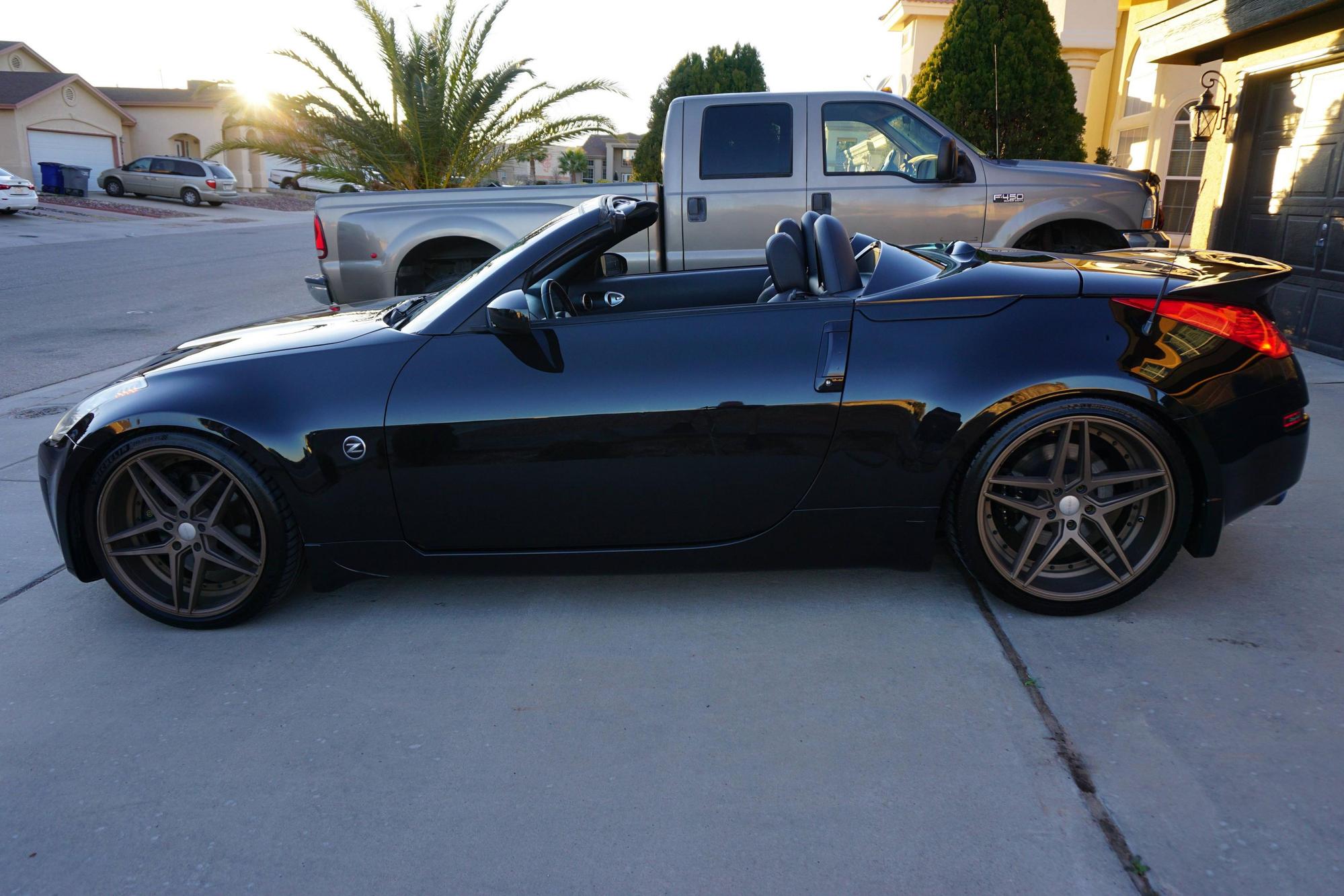

Here's a pic of how low it is now:

Doesnt look super low to me. What size wheels are on it

To.be perfectly honest, raising the car isn't going to appreciably improve the ride quality because coilovers are, well, almost never comfortable. But you can try to raise it a bit; but I would concentrate on taking out the spring pre-load. That may help a bit.
But if you really want to “improve the ride”, dump the 20s (guess) and get yourself a nice “conservative” set of 18s with sidewalls > rubber bands.

I agree with the comments above. Those look like mb 25 sidewalls.
I think you owe it to yourself to go to a Caffeine and Octane meet and ask someone with a more traditional setup (18" with 35% sidewalls ) for a 5 minute ride. You might be surprised how much the tires factor in.

Thanks for the info! The wheels are 20". I didn't realize they made that much difference in ride. I'm not going to bother changing the wheels - I'll just live with the ride. Still, I think I will raise it a bit so I don't have to worry as much about scraping on tall speed bumps.
I've only driven the car about 25 miles so far so I haven't scraped the underside yet but I know my son had some problems scraping sometimes.There are two large speed bumps on the way out of my work that I am particularly worried about. I think I'll drive over there today and crawl over them slowly to see how close it is.
