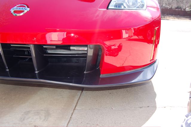

So I noticed today that on the front fascia (terminology might not be quite right) that I have cracks forming on both the right and left side. Also, there appears to be something amiss as a small plastic piece (on both sides) seems to be out of place and it looks like it should be tucked inside. This I think is causing the problem.
First picture is just to locate where I'm at on the car.

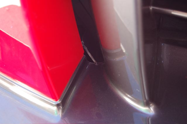

This one is of the right side.
Cracks in Nismo Splitter/Fascia-dsc_0019.jpg

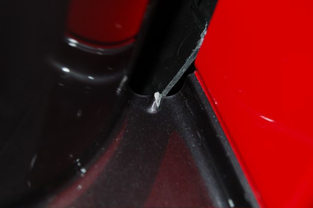

This one is of the left side.
Cracks in Nismo Splitter/Fascia-dsc_0015.jpg
I did a quick search and didn't find any posts pop up quickly so I was wondering if anyone else had this issue? I have grazed the bottom of the fascia but I don't think that's the issue as there seems to be quite a bit of play/flex in it. Thoughts?

A bunch of us have some cracks in the bumper man. No worries, really. It's to be expected when your car has a big nose.

It's that protruding metal part that causes it.
If you scrape the front lip it pushes into the metal,
and causes the cracks. My lip was severely damaged by
that same thing at the stealership during an oil change.
The stealership did fix it, amd repaint it for free.

for those of you that have these cracks can you recall scraping the bottom of the lip somewhere along the line?

Oh hell yeah. My parents have a steep driveway and I scraped the hell out of it when I went to see them.
I park on the street now.

So I guess I'm not going to worry too much about this. However, I'll probably take a dremel tool to it and relieve a little of the material so as to prevent further cracking from the contact problem with that piece in back of it.

smart, before another scrap sends the tear down an inch...as it did to my car...

Same problem. You hit some parking stops or something which caused the bumper underparts to raise and cut into the bumper.
My passenger side is the same way sadly.

I've hit mine hard more than a few times on inclines and driveways and such, and I have to say that splitter holds up pretty well underneath.
It usually only scratches the underbody of the splitter, which you cant see anyways.
However if you hit something dead on, like a curb, or a cone or other debris the vibration may crack the side of splitter, by the front wheels
