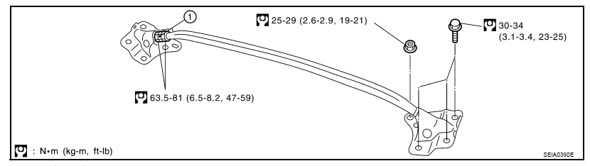

I need torque specs for the front chassis brace

hi, just like the title says, I need the torque specs for the front chassis brace.

the bolts get torqued to 47 ft-lbs
the two nuts get torqued to 125 ft-lbs
Attached Thumbnails I need torque specs for the front chassis brace-chasis-brace.jpg

thanks but i meant the upper brace that connect to the strut bar
oh, ...here
Attached Thumbnails I need torque specs for the front chassis brace-strut-bar.jpg

thank you very much
