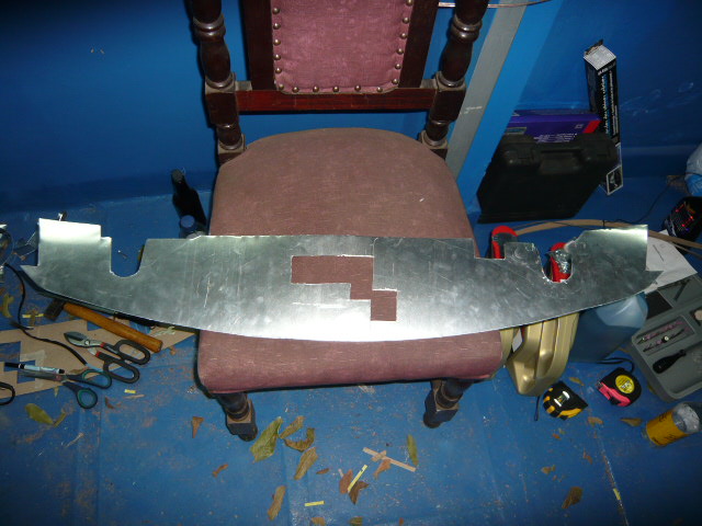

I looked very hard and couldn't find the radiator cover for my NISMO '07, therefore I decided to buy a aluminum sheet(plate) and DIY. SIZE: 1 meter x 20cm
I haven't finish it yet... still need to drill the holes and planning to paint it. What u guys think? Should I paint it? What color? RED, SILVER, BLACK, WHITE...etc...etc. Or should I just leave it the way it is and polish it. Your comments will be highly appreciated. Thanks.

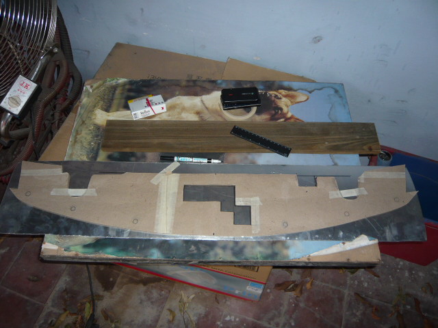

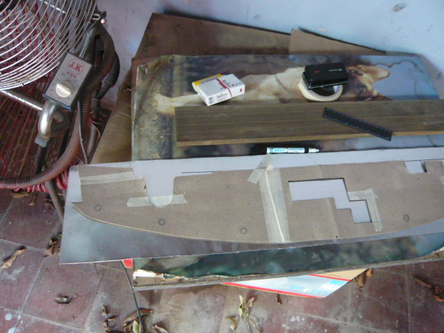

1. Get a piece of CARDBOARD and start drawing the shape u want and cut.

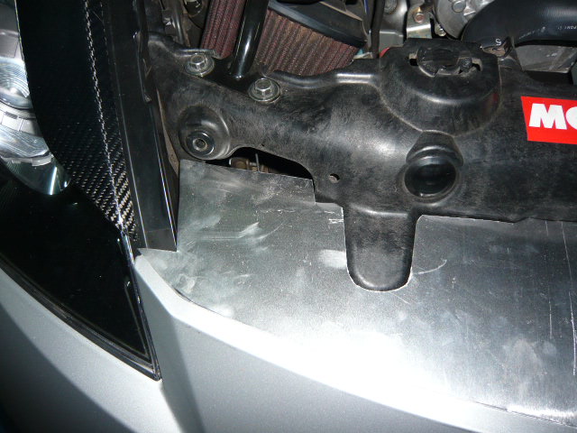

2. Align it and draw the holes.

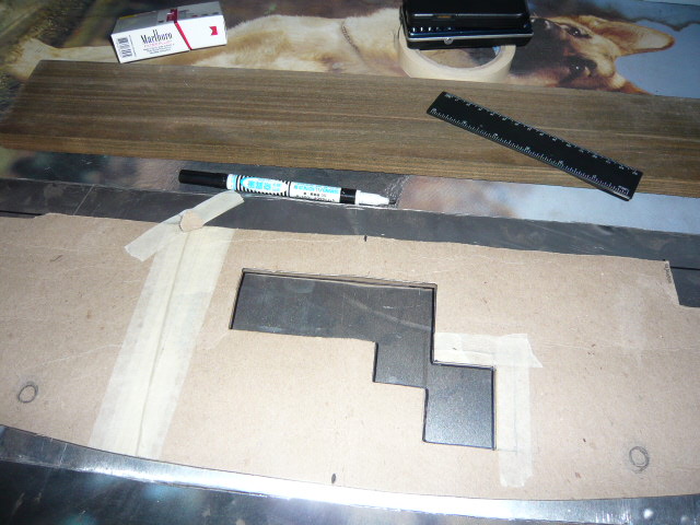

3. Close the hood and draw the hood's line and cut it.

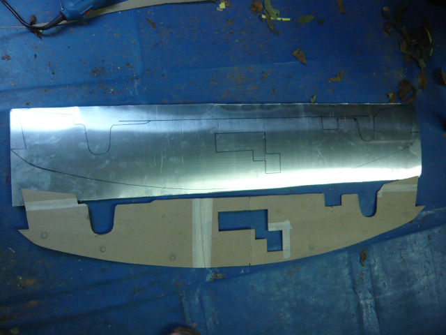

4. Place the CARDBOARD over the aluminum sheet(plate)
5. Use some paper tape to hold it, so it doesn't move around while you draw the lines to be cut later.

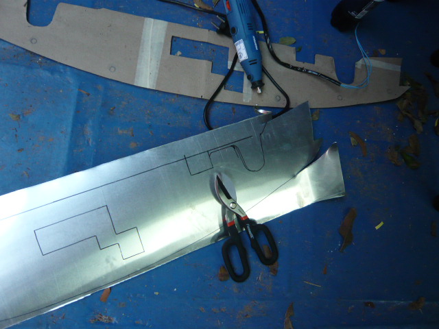

7. Voila... time to start cutting.

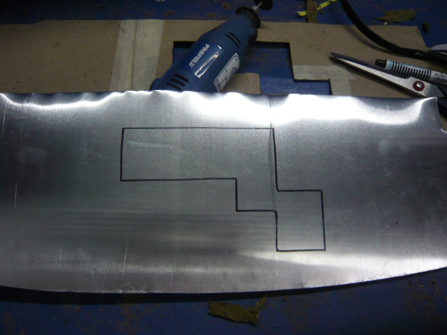

8. I bought a scissor, specially to cut things like aluminum.
9. On those difficult part where I cannot reach in with my scissor, I used this machine. (I don't know how you call it in ENGLISH).
10. Samething here as step #9.

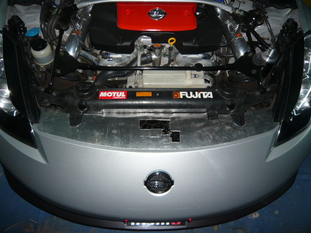

Here are some more pictures. Still need to drill the holes. 100% HAND MADE by me..... lol
I will try to finish it by the end of this week....
Please give me some suggestions, if I should just polish it and leave it the way it is or paint it?
Hope u guys like it.

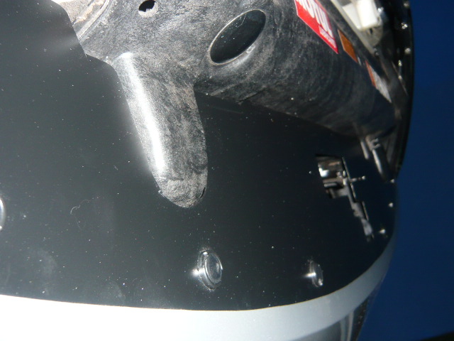

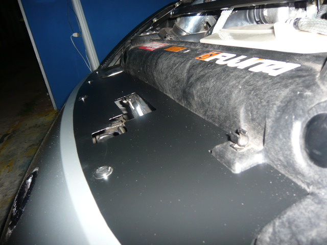

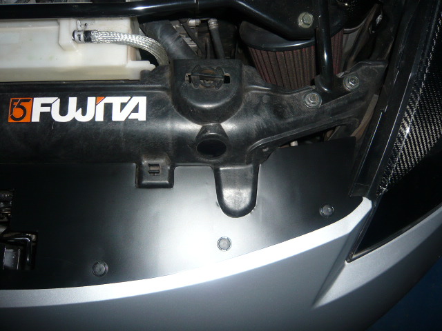

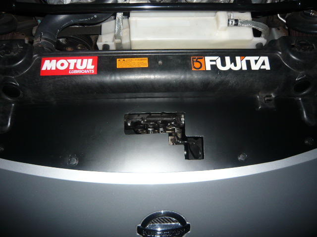

I finally had sometime today to polish it and paint it in MATTE BLACK. I am planning to paint some NISMO logo and my edition number #0300. Or just my initials... What u guys think and suggest???
Here are the pics I promised. Not very good quality coz it was night time already. Enjoy!!!
