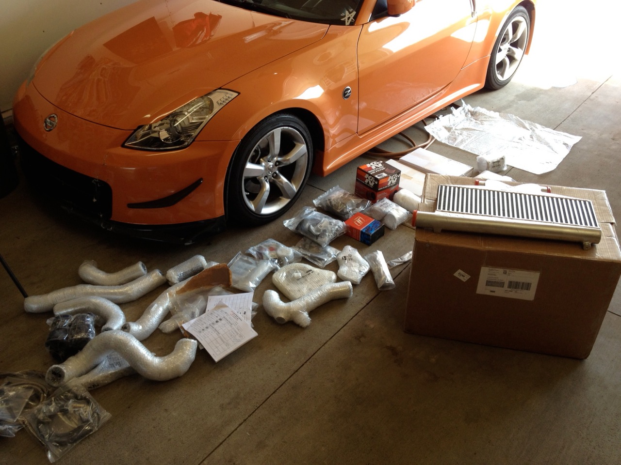

Got started a little later tonight.The actual "build" has begun so taking it nice and easy.
Removed the plenum,fuel rail and injectors
http://www.flickr.com/photos/75614849@N08/7025797963/http://www.flickr.com/photos/75614849@N08/7025797963/ by http://www.flickr.com/people/75614849@N08/, on Flickr
Removed the dirty stock injectors and installed the new Denso 600cc injectors
http://www.flickr.com/photos/75614849@N08/6879744198/http://www.flickr.com/photos/75614849@N08/6879744198/ by http://www.flickr.com/people/75614849@N08/, on Flickr
Cult and lengthen the oil temp and pressure wires 3.5"
http://www.flickr.com/photos/75614849@N08/6879703736/http://www.flickr.com/photos/75614849@N08/6879703736/ by http://www.flickr.com/people/75614849@N08/, on Flickr
Prep supercharger for install
http://www.flickr.com/photos/75614849@N08/7025845625/http://www.flickr.com/photos/75614849@N08/7025845625/ by http://www.flickr.com/people/75614849@N08/, on Flickr
Too bad this is the front of the supercharger. The other side looks better
http://www.flickr.com/photos/75614849@N08/6879735488/http://www.flickr.com/photos/75614849@N08/6879735488/ by http://www.flickr.com/people/75614849@N08/, on Flickr
That's it for tonight. Just about half way through the instruction manual

Ok so did a few hours of work this evening. Install is going very smoothly and everything is fitting perfectly. Only incident was my hand slipped off a rachet and sliced my finger pretty good
rookie mistake. Im pretty stoked about the build now that the shinny bits are going on. M3 hunting in no time
Oil filter relocation. I had to drill three 5/16" holes in the frame to mount the oil filter bracket. Will go with a oem filter.
http://www.flickr.com/photos/75614849@N08/7040944287/http://www.flickr.com/photos/75614849@N08/7040944287/ by http://www.flickr.com/people/75614849@N08/, on Flickr
Reinstall the anti roll bar. It was a tight fit torquing a couple bolts here next to the supercharger.
http://www.flickr.com/photos/75614849@N08/7040945083/http://www.flickr.com/photos/75614849@N08/7040945083/ by http://www.flickr.com/people/75614849@N08/, on Flickr
Lower intercooler piping
http://www.flickr.com/photos/75614849@N08/6894848756/http://www.flickr.com/photos/75614849@N08/6894848756/ by http://www.flickr.com/people/75614849@N08/, on Flickr
K&N air filter and turbosmart blow off valve. I was talking to one of the guys at gtm about recirculating the bov to the intake pipe, but they advised me that the vq35hr doesn't need to have a recirculated setup. Can anyone confirm this?
I mean if it doesn't have to then it doesn't have to. I heard gtm switched from a bosch by pass valve to turbosmart bov due to problems with compressor surge.
http://www.flickr.com/photos/75614849@N08/7040946397/http://www.flickr.com/photos/75614849@N08/7040946397/ by http://www.flickr.com/people/75614849@N08/, on Flickr
Installed the intercooler mid pipes
http://www.flickr.com/photos/75614849@N08/6894850040/http://www.flickr.com/photos/75614849@N08/6894850040/ by http://www.flickr.com/people/75614849@N08/, on Flickr
So i guess that the remaining things left is install some new spark plugs (1 step colder) , upper intercooler piping, and the balance of the stock parts. Gotta fill the car with fluids and prime the supercharger oiling system, install stage 3 clutch and flywheel. Then tune of course.
