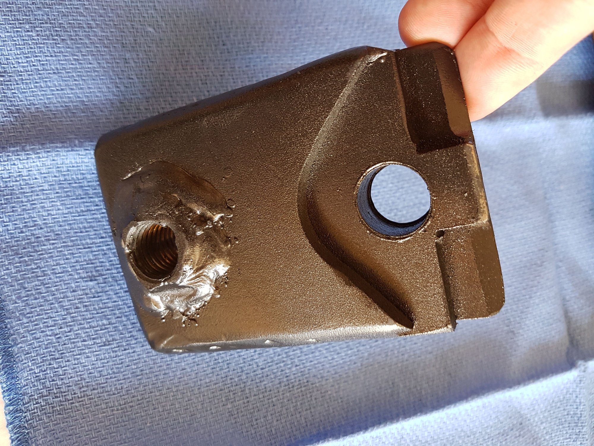

Old Aug 27, 2018 | 03:23 PM
MSGarrett1's Avatar
MSGarrett1
Posts: 375
From: Colorado Springs, CO
This part is key. It relocates the M16-2.0 threaded nut about 2 1/2 inches lower than the factory location on the 2003 350Z
